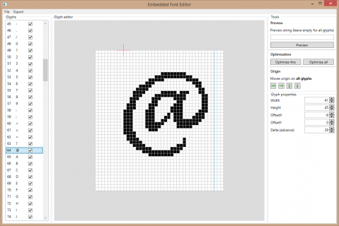

Hi!
Since I couldn't find an easy to use tool for creating and editing fonts for ILI9341_t3, I've created one. So, here it is, Embedded Font Creator:
Features:
  • Create font from scratch (specify size, default offset and delta)
  • Create font from existing system TTF font
  • Easy to use editor with zoom (mouse wheel) and scroll (middle button) as well as continuous drawing

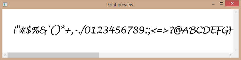

  • Preview the whole font or specific string
  • Batch glyph operations allows quick tweaks (for instance, batch offset change)
  • Quick optimization of character or the whole set (removes empty columns and rows while keeping character's position and size)
  • Export to ILI9341_t3 format (.h + .cpp)
Some more screenshots:
Currently available as source from my repository: https://gitlab.com/spook/embeddedfonteditor (if there's an interest, I'll prepare binary pack). Requires Visual Studio 2017 to build.
Many thanks to Paul for his extensive help on developing this one!

That's excellent! Really nice work.
It's not too much trouble to build it, but not all users of Teensy will necessarily use Visual Studio, so may make it more accessible for those users.

I cannot find a way to create a release in the GitLab, so I'll put the build here, attached to this post. Have fun and please tell me what you think about this app.
View attachment EmbeddedFontEditor.zip

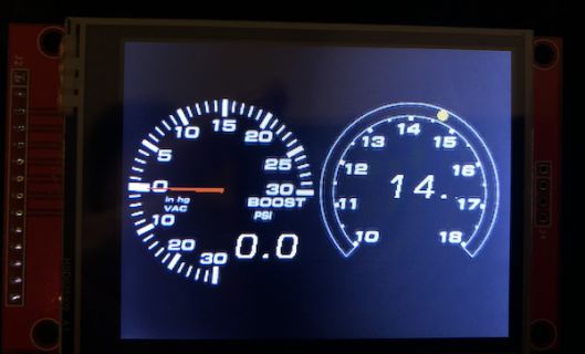

I created a font from 10, 11 and 12pt fonts.
I set the 10pt font to use, but it looks huge, like 30pt huge (its the 0.0 and 14. numbers in the gauges)
Display is a 2.8" ILI3941
Am I doing something wrong, or perhaps my ttf file is bad?
I used another tool that seems to be providing better sizing but its converting to Adafruit GFX fonts
I've tried multiple fonts on font editor and a 12pt font displays twice as large as it should. I'm baffled about it. Perhaps someone else can try and confirm if they are experiencing the same behavior. I suspect it might have to do with how Windows 10 is providing the font data to the application perhaps.

I was able to print special characters like ñ and á by opening a Windows font, then copying from the original 'n' or 'a', then hand-drawing the rest. Adjust the vertical offset for your new character. Reduce delta by a couple of pixels for all characters. Increase the delta for space (0x20) by 2 or 3 pixels. Done.
