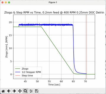

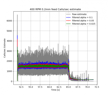

Second, I'm pursuing some sort of display rate limiting, but I'm currently thrashing at that. Since the display is updated in the main loop, I need a way to estimate the number of calls generated and make them appropriate to the varying speeds. I haven't implemented the code on the Teensy yet but I modeled it in Python to get an idea how to implement it at runtime, from the time between estimated updates. I also calculated the number of updates per second, if it was updated every time the carriage moved a micron. It's RPM and feed rate dependent. The answer is given by
update rate [calls/sec] = RPM/60 x encoder x N/D [step/sec] x stepsize [mm/step] x updates [calls/mm] where:
RPM is measured by the ELS, encoder is known and fixed, N & D depend on the feed rate selected, stepsize is known and fixed, as are the updates/mm
For 400 RPM, an encoder of 4096 pulses/rev and N=150, D=8128 (for a feed rate of 0.2mm/rev of the spindle) and a step size of 2.65 um, (and a 1000 updates/mm), I get an average rate of 1333.33 calls/sec. As a consequence, at this feed rate the display of the Z axis is blurry, and there's banding. So on average, the call rate has to be toned down, a lot!
From my logged data (courtesy of the great help I got here on data logging) my calculated from data display update rate the estimates are quite noisy, as I'm effectively differentiating the time difference of the updates. Nonetheless, I ran a script to see what it would look like if I implemented an alpha filter on the Teensy on reciprocal of the time difference between updates (Z changed by one micron). The raw logged data is grey and a mess, the colored traces are the output of simple alpha filters that would be easy to implement in a Teensy. (Have such a filter, for RPM filtering.) This graph is from captured data from my lathe (yesterday). During this (not super fast) feed the display (the little box with the DRO value,) couldn't keep up. Feed time was from about 52sec to 70sec. Although it looks complete at 67 seconds, it took another 5 seconds to come to a stop, within 3um of the stop point. The last 5 seconds seem forever...
I want the position display update rate to be normal at low call rates. I'm willing to programmatically skip updates at fast feed rates, as long as they smoothly transition to "normal" at low rates. I need a signal to control the rate, that's not too hard to compute. I think the alpha filter is over estimating the rates from 65.2 seconds onward. The carriage is just slowly creeping forward, slowing exponentially, as seen in the second graph.
Anyways, that's my question. Any ideas or suggestions would be greatly appreciated. I've probably gone into the weeds, when a simple solution would suffice!

Thanks for that clear and concise explanation. It's quite helpful. Need to digest that. Currently calling the function too often. I had implemented a counter like scheme for my RPM updates, probably should extend that to the display. My RPM is updated at 50 Hz, (and alpha filtered) which ought to be in the ball park of the display. The period of 60 Hz, is so irrational...
Well, thought about this, and came up with something simple. Pretty much what both of you said. I have a variable displaycount that is incremented every 20ms so the simple statement
C-like:
if ( (displaycount % 2 == 0) && ( (menu == 0)||(menu == 6)||(menu == 7) ) ) {
    updateDROs();     // Display positions of linear encoders
seems to work well enough. If I have to, I'll make it 3, instead of 2. (60ms, rather than 40ms) But it's much better now, so that's good. On slow movements you can see it display at the resolution of the DRO encoder. Menu refers to the different screens that I display. Menu 0 is the main menu, and menu 6 is my new "experimental" menu with my feed to stop algorithm. Menu 7 has yet to be written, but is for thread to stop, which is a bit harder.

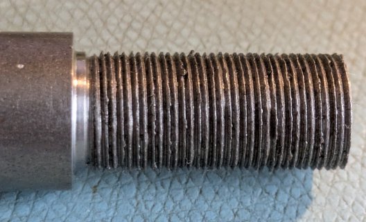

I'm going to reopen this thread. I have an intermittent fault, which may or may not be display related. I have implemented a thread to stop algorithm, on my electronic lead screw. I am getting an intermittent delay after synchronization, which manifests itself as a ruined thread. I can get 5 or 6 perfect cuts, and then kablooey, the screw is ruined. This is not good.
At a top level, the code pauses the stepper motor at a precise repeatable location, and waits for the spindle angle to be correct. To the best of my testing, it always syncs on the correct angle. But sometimes the stepper motor doesn't start on time.
All the important things are on interrupts, such as the rotary encoder, two linear encoders, the stepper pulser one shot timer and the RPM update. If any of them occur, they are too short to materially affect sync.

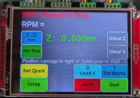

However, updating the display, occasionally can result in a significant delay. Based on the rotation rate of the lathe, (240 RPM) it appears the start of the motor was delayed by nearly 125 ms. This resulted in a new thread being cut in between the original thread, but being shifted by about 180 degrees. (Later, I'd like to do that on purpose, but I need to get simple threads to work first!). It's supposed to cut a 1.5mm thread, and it did, but the last cut was also 1.5mm pitch, but the start point was rotated by about 180 degrees. When not in this mode, it cuts perfect on dimension threads, not this ugly looking stuff you see here.
When this error occurs, there are no missed encoder counts, nor missing DRO counts. Everything looks normal. No parameters are out of place, there are no errors logged. Here is a picture of the screen. Only the RPM, and Z axis are updated periodically. All the other items are static.
