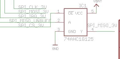

So basically after reading the PRJC page of tri-state spi you need a buffer circuit that looks like the one on cc3000 from adafruit:
Well another redesign for me :) Easy enough though
NOTE: VBAT would be 3.3v

@defragster, @KurtE and others
Ok, I got the sn74ahc1g125 ordered. But I do have a question, OEbar in the diagram is tied to say the display CS. Is this all I need - what about T_CS? Do I also add pull up resistors to the CS lines?
don't know the sn74ahc1g125 device - but AFAIK TFT_CS select (LOW) should enable the MISO signal. When TFT_CS is not selected it needs to tri-state on the common MISO line. When inactive all CS lines need to go high so adding pullups won't hurt - but needing to add them depends on having more than one device and not having them default to high when not selected? Since the Touch hardware MISO does tristate and T_CS is handled properly with that it works without add/change in hardware.
