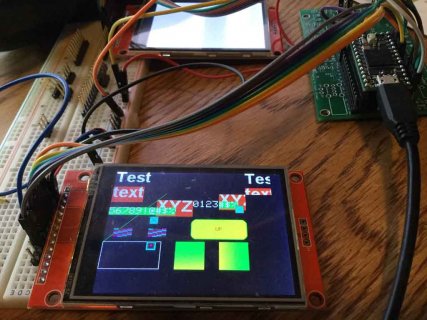

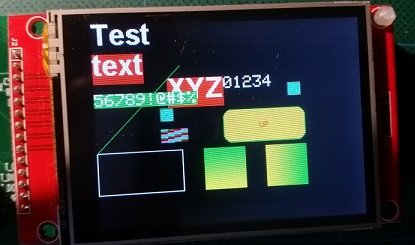

With the Teensy 3.2-3.6, I mostly saw that it was the SSD1306 (OLED screens) that were problematical with higher SPI bus speeds. I don't recall having to slow down the SPI bus for the ST7735, but it maybe at the faster Teensy 4 speeds you do.
Think that should be mandatory readingThe pull-up resistors comes from Paul's paper about better SPI bus design:
https://www.pjrc.com/better-spi-bus-design-in-3-steps/

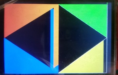

#include "ILI9488_t3.h"
ILI9488_t3 tft = ILI9488_t3(&SPI, 10, 9, 8);
tft.begin();
tft.setRotation(2);
tft.fillScreen(ILI9488_BLACK);
#define DELAY 500
tft.drawTriangle( 0,0, 160,0, 0,240, ILI9488_WHITE);
tft.fillTriangle( 0,0, 160,0, 0,240, ILI9488_BLUE);
tft.drawTriangle( 310,0, 160,0, 310,240, ILI9488_WHITE);
tft.fillTriangle( 310,0, 160,0, 310,240, ILI9488_ORANGE);
tft.drawTriangle( 310,460, 160,460, 310,240, ILI9488_WHITE);
tft.fillTriangle( 310,460, 160,460, 310,240, ILI9488_GREEN);
tft.fillTriangle( 0,460, 160,460, 0,240, ILI9488_YELLOW);
tft.drawTriangle( 0,460, 160,460, 0,240, ILI9488_WHITE);
delay(DELAY);
Actually if you look at ili9341_t3n log on April 8th, there was a fix for fillTriangles.
So in ILI9488.t3.cpp line 2147, try changing int16_t to int32_t...
And see if that helps
