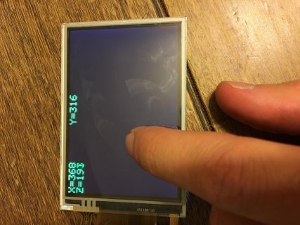

I've run in to an issue once I pull in the touchscreen library. The display will switch to rotation 4 by itself and the display will be mirrored (backwards). I have tried it on all 4 rotation and it always switches to mirrored rotation 4 If I remove the touchscreen library and code everything works fine. As well if I have the touchscreen library and code in the sketch but I disconnect the touchscreen from the t3.6 the display will work fine. I'm using a resistive touchscreen without a controller so all four pins are wired to the t3.6. Would I be better off trying to incorporate a touchscreen controller?
#include "SPI.h"
#include "ILI9488_t3.h"
#include "TouchScreen.h"
#define TFT_RST 8
#define TFT_DC 9
#define TFT_CS 10
ILI9488_t3 tft = ILI9488_t3(&SPI, TFT_CS, TFT_DC, TFT_RST);
#define YP A18
#define XM A19
#define YM 5
#define XP 6
#define TS_MINX 120
#define TS_MINY 50
#define TS_MAXX 920
#define TS_MAXY 940
TouchScreen ts = TouchScreen(XP, YP, XM, YM, 300);
#define MINPRESSURE 10
#define MAXPRESSURE 1000
void setup(){
  tft.begin();
  tft.setRotation(3);
  tft.fillScreen(ILI9488_BLACK);
  tft.setTextColor(ILI9488_GREEN, ILI9488_BLACK); tft.setTextSize(3);
void loop(){
  touchscreen();
void touchscreen(){
  TSPoint p = ts.getPoint();
  pinMode(XM, OUTPUT);
  pinMode(YP, OUTPUT);
  tft.setCursor(0,25);
  tft.print("Z=");
  tft.print(p.z);
  tft.print("  ");
  if (p.z > MINPRESSURE && p.z < MAXPRESSURE) {
    tft.setCursor(0,0);
    tft.print("X=");
    tft.print(p.x);
    tft.print("  ");
    tft.setCursor(200,0);
    tft.print("Y=");
    tft.print(p.y);
    tft.print("  ");
@slapstick

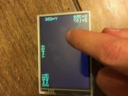

I don't have a display like yours to test with. But just looking at the library I see no reason why it would do that, but I am still on my first cup of coffee.
Do you have a link to the display that you have.
@slapstick and @mjs513, I don't have the same display, I have one from BuyDisplay which has a completely different touch screen.
BUT I have run into the ILI9488 screwing up like you mentioned and end up with things reversed, and wrong orientation...
It is like somewhere the system sends out or the display at least thinks it has received a bogus: MADCTL command.
Which is one reason I added the ability to set the SPI speed as part of the begin method as part of the last update...
Maybe it is not handling the default SPI speed requested 30mhz or if your have your system configured to have F_BUS >= 64mhz... 64mhz...
When I was seeing the symptoms you mentioned, I did not see any rhyme or reason for it to happen.
I am also just on first half cup of coffee!

I was able to get the ili9488 to work properly if I reduce the spi clock speed like @KurtE suggested. At 19mhz the problem went away. At 20mhz the problem is still there. This slows the display down significantly. Do you know if there is something that can be done in order to bring the clock speed back up and not have the display rotate to rotation 4 and mirror the image?
