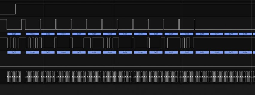

Again first try running the wave share software with this and see if it works.
Also If I look at pictures of your module, I am assuming that you changed the dip switches on the display to use SPI pins on 11-13 and not use the ICSP pins?
It will be interesting to see how different this controller is. I do have their example outputting on T4, looking at its outputs on Logic Analyzer. And I am wondering if some of the basics are different. Example how to output the bounds for writing data to a rectangle.
Example:
It shows like: 0x2a 0 0 0 0 0 1 0 df 0x2b ...
It is like the min/max values are 4 bytes each but only probably lower byte of each 0-1df would be my guess.

Again why I asked was if you look back a few postings to #605 you will see the Logic analyzer output, which if you remember I mentioned looked wrong! With that change it looks more like:
Now you see the: 2a followed by 4 bytes (2 bytes for x Start, 2 bytes for x end) followed by 0x2b again 4 bytes (y start, y end) followed by 2c (write memory)...
This is the same as I see for ILI9488, ILI9341, H8357, ST7789. ST7735 is similar except as both directions are less than 256, the X and Y coordinates are one byte each...

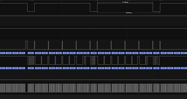

The use of the pair of 74HC4094 shift registers to emulate a SPI interface on the 8080-16 wired ILI9486 makes things interesting. Without access to the full schematic (in particular the wiring involving WRX & SCLK at the ILI9486 interface) it’s hard to confirm, but my thought was that your proposed change may indeed still shift & present the same values into D[7:0] as in the original code but I wasn’t confident yet that we’d see WRX latch at the same time as with the original code.
As you said, there’s no substitute for trying it out on the hardware :) I should have access to the Waveshare & T4 on Monday evening and so may be able to take a look later if there was still any interest (though perhaps less so now that sep89117 has indicated concerns over his particular module).

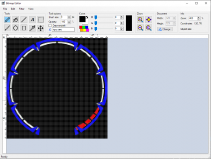

Hello everybody!
Coincidentally, is anyone interested in an image editing program that can import from C as well as export to C? So it specializes in graphics creation for Arduino based systems.
I have been working on it for a few days now and would be happy to find beta testers :)
It is written with C# .NET in Visual Studio. I can of course provide the source code and also a compiled executable for Windows.
I also developed a new type of Exprt to C. With simple bitmaps (many pixels with the same color) it can save up to 99% memory (bitmaps like the one in the picture as an example). It is rather unsuitable for images with color gradients or strong noise.
I am looking forward to your feedback
What I do with images, is to save them in png/jpg/etc from Photoshop and have a command line tool to convert the file to .h in given format.
