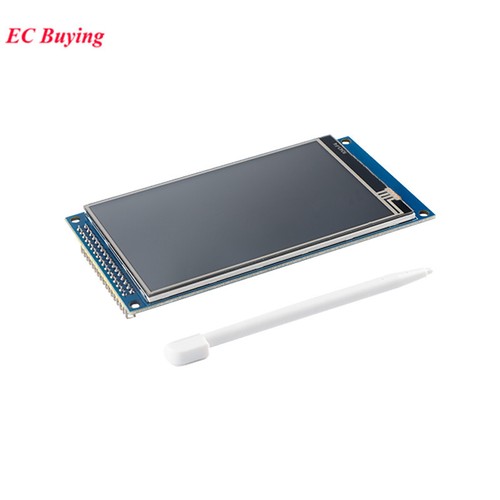

Thought I would mention that @mjs513 and I have made some progress on the NT35510:
Current stuff is up at: https://github.com/KurtE/NT35510_t4x_p
At the moment it only supports 8 bit Parallel, using 16 bit color (RGB565)
I am currently testing it using the Dev Board 4.5 and I believe that @mjs513 is
testing it using a Teensy 4.1. We are both using the BuyDisplay board mentioned above.
I currently have another display ordered on Ebay that is configured for 16 bit transfers.
