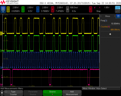

I ran your program here on a Teensy 4.1. These are the waveforms I see. Is this correct?
Assuming this is the waveform you really want, and you really do intend for the clock to be continuous and the data to immediately repeat, this looks like a job for the SAI (digital audio) port.

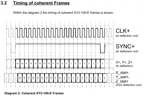

Comparing these waveforms to the SS-III XY2-100-E documentation, I see the sync signal polarity is high for 19 of the 20 clocks. But the waveforms on msg #6 have it high only 1 of the 20 clocks.
I did some fiddling. Here's a quick test using TDM output code copied from the audio library.
This probably isn't perfect, but hopefully it will give you a good start. It generates 10 MBit/sec output and calls isr() every 20 clocks as new data is needed. The 2 data streams transmit on pins 7 and 32. Sync is on pin 20 and bit clock is pin 21.
You'll probably want to edit some of the I2S1_TCR and I2S1_RCR register settings if the waveforms aren't quite right. Documentation is in the IMXRT1060 reference manual (rev 2) in the SAI chapter. Turn to page 1981 for the register defs.

The falling edge of the SYNC line is arbitrary -- it just has to be low before the next frame starts. It looks like your attachment links are invalid, however, so I can't see the waveforms you've produced. Can you re-upload?
