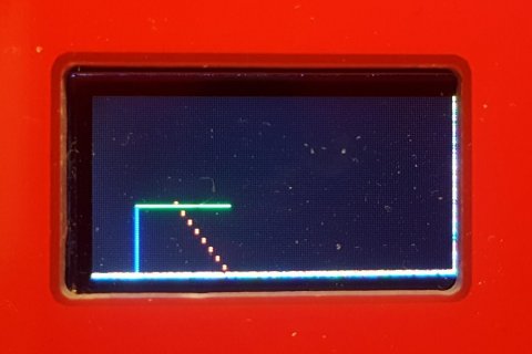

Using the code above there are the following problems:
Blue and red pixels swapped (yes the pixel order is evidently different)
The rows and columns are offset causing random pixel data at the boundaries
Turning frame buffering on is causing the top half of the screen to disappear or sometimes flash:
INITR_GREENTAB in 1.48 worked perfectly (unmodified), even if it was meant for a different resolution. Another initialisation scheme would be good, as anyone not using Adafruit displays are likely using these cheaper ones with semi-random variations. The one I'm using is quite ubiquitous.

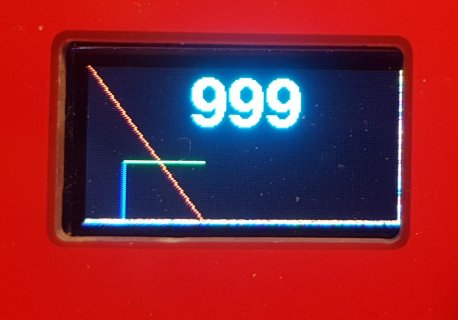

Produces:
Using invertScreen(true) produces:
Setting row has no effect and the row seems to start from 2 which is why the right vertical line doesn't appear. I think the top horizontal line starts at 1 however.

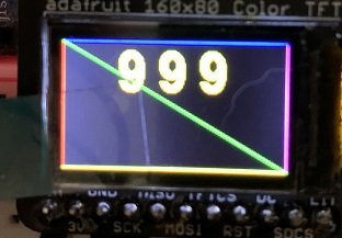

I hooked up my adafruit mini display(160x90) st7735s and it seems to be working. In regard to the sketch in post 36. If I comment out setrowcol and invertdisplay and use:
    tft.drawLine(0, 0, 0, 79, ST7735_RED);//left vertical
  tft.drawLine(159, 0, 159, 79, ST7735_MAGENTA);//right vertical - DOESN'T appear
  tft.drawLine(0, 0, 159, 0, ST7735_BLUE);//top horizontal
  tft.drawLine(0, 79, 159, 79, ST7735_YELLOW);//bottom horizontal - DOESN'T appear
  tft.drawLine(0, 0, 159, 79, ST7735_GREEN);//diagonal across whole screen
it seems to be working,
IMG-0162.jpg Lettering is actually Yellow. So it must be something with the non-adafruit displays.

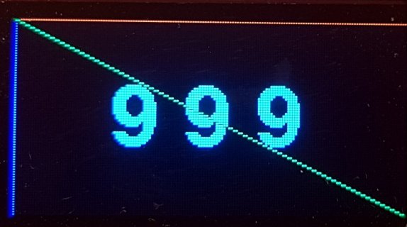

Note: I added stuff to flash some different colors, plus fixed the lines to all work as the pixels are 0 indexed so 0-79 and 1-159
And I now have:
Good news @KurtE! Have you posted exact part links to the 2? displays you are working on? "Digikey where I purchased a couple of Adafruit ST7789 small displays 240x135 and some funcky supposedly ST7735 .96" 160x80 display."

Just downloaded the updated lib and ran your sketch on the Adafruit ST7735S display. The colors are off using INITR_MINI160x80_ST7735S with the Adafruit display. However, if you use INITR_MINI160x80 it seems to work as it should. Here is the list of colors I see with INITR_MINI160x80_ST7735S:
White, Magenta, Yellow, Cyan, and back to white.
Just figured I would let you know. Probably need some warning about that one.
EDIT: Basically it looks exactly like the image in post #36
