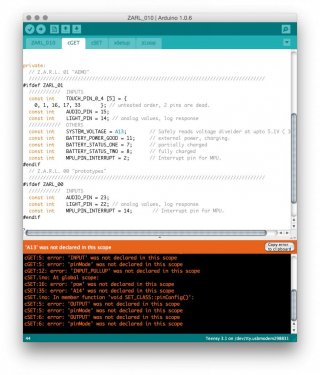

I am trying to learn/implement classes in my program, however I have hit a strange compiler error that I can't solve. Some how there references to the Teensyduino libraries are getting broken. However this only happens in one case.
I am not confident in my implementation, and use of static, however I can't find any error between the two implementations. One compiles, and one gives weird errors. Any help or suggestions welcome! :)
Arduino 1.0.6
Teensyduino 1.20 (downloaded and installed today)
The code should compile on copy/paste, but swap the commented //#define and the second should fail stating OUTPUT undefined, and highlighting the wrong line.

Alright, restarted with a simplified approach. Was compiling frequently, then hit the same problem, but I was able to take a few steps back and saw I had accidentally nested #ifdef statements. I saw this trick online, but I didn't consider that I had an #ifdef in the code I was to mark as old!
Apparently #ifdef cannot be nested! *shrugs* :roll eyes:
ATTACH=CONFIG]2791[/ATTACH]

Note, you have the wrong syntax for the second #ifdef.
You wrote:
#ifdef ZARL_01 analogWrite ( VIBE_MOTOR, 1023);
The #ifdef can only be followed by a single identifer, i.e.:
#ifdef ZARL_01
Since the IDE, decides to hide some error messages (particularly include file not found), perhaps it is deleting the error message that the compiler gives that the #ifdef is mal-formed. So, the first #endif winds up closing the first #ifdef, instead of the second, and the second #endif is also an error.
Thanks for the clarification!
I went back and played with this... and strangely the error is completely gone, regardless of the syntax mentioned above.
... I'll be proceeding with caution.
The #ifdef isn't very clean in my implementation, but it is convenient to have one piece of software work on two different hardware iterations of the same project!
