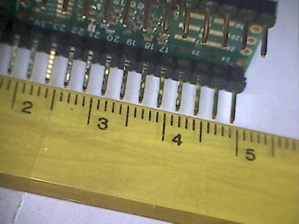

Hi, I've soldered 0.1" pin headers into a new Teensy 4.0 so I can insert it into a 'push-in' prototyping board to create a hardware test platform. However hard I push, the device won't go in, I suspect the problem is simply the number of pins involved. Standard wired components such as resistors go in OK, the force required is consistent with my experience so I don't believe the adaptor is unusual. I'm wondering whether the Teensy boards supplied with pin headers already fitted use a thinner pin than standard to avoid this situation.
Is there a trick involved or is it just a matter of pushing with enough force?
The attached gives an idea of the pin size I'm using (fine divs in mm of course).

Perhaps this is a standard proto breadboard? Have had them here where from new the internal contacts are individually tight and even pressing in a single dupont solid connector end is hard and takes some effort the first time.
Would suggest individually inserting such a hard wire end into each hole in both rows to make sure they are functioning properly.
Don't force the single pin - but apply gentle repeat pressure as needed. Perhaps the internal clamping contacts are not properly aligned or are overly tight. If a pin can individually be inserted to good effect in all needed holes, then the pinned Teeny should then work more easily.
It should never take excess pressure that could damage the pins or board, it is even worse on a longer T_4.1 board and they can work - but even tougher to remove.

Thanks so much Defragster. Your suggestion worked a treat. I first tried using a standard 1/2watt resistor as a 'loosener', that didn't improve things at all. Then I tried a fine gauge galvanised steel wire (not sure which one, diameter is a bit larger than the resistor), once that was done the module slid in nicely, with plenty of resistance to indicate that contact was good but not requiring excessive force.
