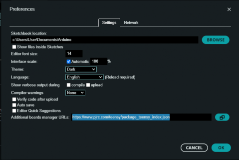

I wanted to bump this, I'm having the same issue on a Windows 11 computer with an install of Arduino IDE 2.1.1
The "Additional boards manager URLs" contains the proper link to https://www.pjrc.com/teensy/package_teensy_index.json Screenshot 2023-07-16 194738.png
Hey @Heavy_Metal . Thanks for your reply. Ok I was able to install Teensyduino.
I went to settings. I put the link in the "Additional Boards Manager."
Then in the Boards manager of the Arduino sketch page I put Teensy and there was an option to install Teensyduino and it seems to have worked.
Thanks for the suggestions.
To cause Arduino IDE to redo the package index update (maybe something went wrong the first time?) press Shift-Ctrl-P and click "Arduino: Update Package Index". Keep an eye on the "Output" tab in the console area below the main code editor. If something goes wrong, it will probably give info there.

Could be a typo in the URL. But the screenshot in msg #2 looks ok.
If the Shift-Ctrl-P -> "Arduino: Update Package Index" trick doesn't fix things, before we try to get Per involved for info about how to *really* dig into the nitty-gritty of whatever Arduino IDE is really doing, please show screenshots of your Preferences and Boards Manager with "teensy" search giving nothing. With technical problems, often a misunderstanding (especially if the directions aren't as clear as they should be) can only been seen with a photo or screenshot.
