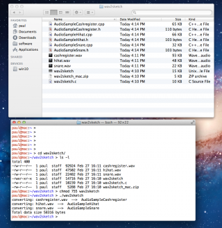

To use this, first create an empty folder. I made a folder called "wav2sketch" from my home dir. Put the zip file in that folder and extract it. Also put some WAV files in the folder. This program converts whatever WAV files happen to be in the same folder.
Open Terminal.
To get set up, you're going to type 3 commands. First use "cd wav2sketch" (or whatever folder name you used) to change the current working directory to the folder you created. Then type "ls -l" to see a list of files. The only reason for "ls -l" it to make sure you've successfully changed to the folder where you put this stuff. If your Terminal opens with you using a different folder, you're going to have to fiddle with "cd" commands until you manage to get to the folder you created.
(click for full size)
Once you get to the folder and you can see the files with "ls -l", there's one more prep command to type: "chmod 755 wav2sketch". This sets the execute permission, so you can actually run the file. Like most unix commands "no news is good news", it prints nothing if it works. See the screenshot above.
Then to run it, type "./wav2sketch". If you get "Permission Denied" the chmod command didn't work. If it works, it'll print a few lines telling you what it did (not the normal "no news" unix approach). You should see something like this:
Probably best to do with with a familiar Finder window open next to Terminal, as I did for these screenshots. When it works, you'll see the Arduino compatible .cpp and .h files appear. Or you can type "ls -l" in Terminal, but at this point you can just quit Terminal and use the files.

each .cpp file is a bout 8 MB !!! that's not right, right?.
I would have expected an 11.4MB WAV to produce a .cpp file much larger than 8MB, unless perhaps the input was a stereo file and the output was reduced to mono.
The T3.2 has 256kB of flash memory and 64kB of ram. Files of over a megabyte aren't going to fit and is why you got the error message
... section `.text' will not fit in region `FLASH'
... region `FLASH' overflowed by 22557984 bytes
A T3.6 has 1MB of flash and 256kB of ram so those files won't even fit in the largest Teensy available.

Best would be to learn the absolute basics before. At least learn what a compiler (esp. gcc) is, and what it does :)
The size of the .cpp files does not matter. The binary file size (before converting the files to .cpp) matters.
I wish to use many samples - should I use the SDplayer?
No, use a SPI Flash. SD does not allow to play many samples simultanously.
To estimate the data size, look at the array definition. For example:
#include "AudioSampleCashregister.h"
#include <Arduino.h>
// Converted from cashregister.wav, using 22050 Hz, u-law encoding
PROGMEM
const unsigned int AudioSampleCashregister[5809] = {
0x02005AB4,0x82060707,0x03010301,0x08038287,0x81820200,0x09120407,0x15091108,0x02080611,
0x0D050D11,0x8008150C,0x93810480,0x000D8890,0x0A060406,0x06000681,0x80828702,0x89928405,
0x04820983,0x8C860D05,0x880D0004,0x84000B0B,0x8C8D8C8F,0x84829181,0x14860600,0x0A0C080C,
In this case the array is 5809 items, and each item is a 4 byte integer, so the size is 23236 bytes.
If your sounds are long, I'm afraid the limited internal program memory probably isn't going to be enough, no matter what you do. But if you want to try, editing the sound in Audacity or other programs, to reduce the sample rate and trim off any silence or very low amplitude trailing sound is usually the best way to save space. But the 256K internal flash is really only enough for a small collection of very short samples.
For longer sound clips, add a SPI flash chip.
