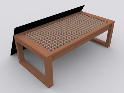

Hi everyone, I was looking for guidance on a project I started some months ago. I am trying to make an interactive (touch-sensitive) LED table for my living room. I'm sure most of you are familiar with what I mean but for clarity this link isn't at all dissimilar to what I am trying to achieve. I am aiming to tackle this project in a series of steps, each more ambitious than the last. The first two steps I have a pretty good idea of how to tackle or have already addressed to some degree, however, I have no idea how to begin the last steps. Anyway, broadly speaking, this is the plan:
1. Table design and construction
2. Electronics installation for LEDs to be controlled via Teensy 3.1
3. Wifi control using something like a Raspberry Pi and coding for games etc.
4. Incorporation of touch-sensitivity using IR emitters and sensors (reflecting IR off hand for single pixel resolved 'touch' detection)
I have already progressed as far as beginning construction - a computer model of what it will look like is shown below. I've also used OctoWS2811 to program a strip of WS2812b LEDs successfully. Combining the LEDs with the completed table shouldn't be too hard, and I'm fairly confident with how to achieve this. However, to avoid complications later on I want to design the system in such a way that the IR LEDs and sensors can be easily incorporated into the existing electronics. As I have very little idea of how to do this I thought I should ask here.
The carpentry isn't a problem at all. As for the RGB LEDs - I am using WS2812b 60 LED/m strips but cutting them into single LEDs (most cost efficient, and each 'pixel' must be 2 inches apart) and then I'll reconnect them with short lengths of wire. I had hoped to use something like very low profile copper tape instead but I don't think it will work or could handle the current - although it would have been much neater than bundles of wires! Then I will attach each strip (12 strips of 24 LEDs = 288 LEDs) to the Teensy. However, when I return to add the IR electronics later on I anticipate that I'll have to redo all the wiring, unless I plan for their future addition early on.
So what I would like help with is how to use IR sensors. Obviously there aren't 288 inputs on a Teensy for each IR sensor so presumably I have to do something like how the WS2812b LEDs work, but in reverse. I really don't know how to approach this but I imagine it's a fairly common thing in electronics. If you could describe how it's done or point me in the right direction it would be really appreciated! I would prefer being able to detect more than just ON or OFF - I would like a degree of touch between 0 and 255 for example (not touched to completely touched). My feeling is that each strip would have to be encoded into a digital data stream and then something... how...?
I would also like to code any games etc. in Java, so I thought the Teensy could take care of the pesky time-sensitive LEDs and interacting with the IR sensors while something like a Raspberry Pi could communicate with it and run the games, does this seem sensible?
A little background regarding myself: I frequently code in Java to produce software/games, however, although I understand electronics I haven't done anything like this before. Hopefully I'm not being ridiculously ambitious!
Finally, does this all seem okay or am I missing some quite fundamental/important points?
Thanks!
This page might help. Scroll down to "Connecting Many Buttons & Knobs/Sliders".
http://www.pjrc.com/teensy/td_midi.html
There are a lot of ways to do this. The 74HC4051 mux chips are probably the simplest and cheapest.
Another popular way is with "I/O expander" chips. Most of other interface using I2C, which you access with the Wire library. I know Adafruit, Sparkfun and others sell these on boards. I personally haven't used those I/O expander boards, but perhaps some else here has, and might recommend one?
I've used the MCP23017 i2c board that Adafruit sells: https://www.adafruit.com/search?q=mcp23017.
It is great for adding 16 digital inputs and/or outputs. It has 3 address pins, so you can have up to 128 inputs/outputs on the common i2c bus. With Teensy 3.1, you have the option of 2 i2c buses, so in theory you could hook up 16 MCP23017's for 256 pins. I suspect you will run into electrical problems if you have so many devices hung off of a single Teensy.
To hook up i2c devices on the Teensy 3.x, you need to add 4.7K ohm pull-up resistors (between the pins and power rail) to A4/A5, and connect A4 to the SDA pin, A5 to the SCL pin, and connect the 3.3v/ground wires. The MCP23017 will work with both 3.3 and 5 volts.
However, since you want the ability to have more than binary (on/off), it would not be appropriate for your task.

Perhaps instead of using IR sensors you could use something like the touch (capacitive) sensors built into the Teensy. Trouble is there aren't 288 of them, but...
Consider laying out an X-Y grid of wires and small (1N914 or 1N4148) diodes at each intersection. Say 18 X and 16 Y. Now select one X column and drive it high, drive the others low. Read the logic level on all 16 Y (inputs). Drive the X low (so now all are low), and continue reading (looping) the Y lines and detect the first one to go low. That would be the one with the most capacitance on it. Loop over X to get the X position.
I don't know how well this would work in practice -- the additional touch capacitance might be too small to detect, and the results will also be noisy. You'll also have to calibrate the system (measure all X-Y points with 'hands off' and subtract that from the measurements above). YMMV
Might be best to user another Teensy for this and have the 2 communicate over I2C (although using a T3 as an I2C slave doesn't seems to work well); perhaps SPI or SCI ?
Teensy has 34 digital I/O's which is enough for this, but not for the I2C simultaneously -- but you can reuse the X lines (wouldn't want to add capacitance to the Y lines) for comms after each measurement by making the other Teensy ignore 'strange' signals.

This might work - http://www.ti.com/general/docs/lit/getliterature.tsp?genericPartNumber=adc101c021&fileType=pdf 10-bit I2C ADC and can have 9 different addresses which simplifies connecting to the I2C bus.
If you drive the (16 ?) rows looping with only 1 on at a time, you can have 2*9 ADCs (say 9 left and 9 right, with 9 addresses in each group) on each row. They could be powered from the same signal that powers the IR LED, and all ADCs in a column (16*9) can share a single I2C channel on the Teensy as the unpowered ADCs won't interfere with the active ones on the same I2C bus. That's a lot of ADCs though, but it minimizes wiring.
I need to have 12 rows of 24 LEDs giving a total of 288 LEDs. I've looked around and it seems ADCs come in I2C format, like the one you found, and SPI or 'regular', i.e. 1 pin per bit versions, whatever that's really called. I don't pretend to completely understand I2C or SPI but as I understand it SPI wouldn't work because I think you need an additional pin to for each address and the T3 doesn't have 300 or so pins. However, I2C would be okay if there were enough addresses. I thought they come in 7-bit and 10-bit address versions giving 128 address (too few) or over a thousand addresses (plenty!). So I'm not sure I understand why you say these have only 9 addresses - definitely inexperience on my part, I'm sure! Anyway, I thought that each pixel (all 288) should have it's own ADC because each must have it's own IR sensor. In which case should I be looking for an 8-bit ADC with 10-bit addresses? Note: I don't really need 0 to 255 - I'd be happy with 0 to 10 but I would guess that 8-bit is as small as it gets for ADCs.
Is this a better (faster read speed or easier/cheaper) than just using 288 shift registers? I was thinking about having one 'regular' ADC connected directly into one shift register per pixel. Then the shift registers would effectively add up to a giant 8 x 288 (8 bit and 288 pixels) = 2304 shift register. I could then take the parallel data and read it off as serial chopping the 2304 bits up into groups of 8 and evaluating each of those 8 bits as a 'touch level' between 0 and 255. I'm not experienced enough to know which is better or more suitable a method. Thanks for the I2C idea - I guess the viability of that idea depends on the number of addresses being over 288? I'm not sure I understand what you meant by looping through different rows I'm afraid. But anyway, I will have more than 9 pixels per row or column unfortunately!
In the TI part, there are 9 different addresses to choose from. I2C does have 127 addresses, but most products can't be configured to have any arbitrary choice of those.
(Converting to your 12x24) My concept was to have 12 rows, and 24 columns on each with a set of LEDs and an ADC at each intersection. In each column there are 12 ADCs (one per row) configured with addresses 1..6 and one set of SDA&SCL lines, and 1..6, and another set of SDA&SCL. Connect the 1st pair of SDA&SCL to one T3's I2C port, and the other to another I2C port. Configure the system that when you select a column, all the ADCs on it get powered (each is < 1 mA). Your two I2C ports can now each scan the 6 addresses and read the conversions.
Here's the trick -- I think you can connect all I2C ADCs in single row with the same address, and shared SDA & SCL lines. ADCs on columns which are not selected (i.e. not powered) will not interfere with the I2C bus, so you can effectively have 24 ADCs, each with the same address, but only one powered at a time at a single address.
This is nonstandard and you'd have to confirm it works before investing too much in it. The I2C bus will be slower than normal because of all the capacitance on it.
If this 144-ADC idea doesn't work, you can still MUX the lines with port expanders, but that makes wiring and assembly more complex. Or look for 10- or 12-input ADCs, but be wary about the IR detectors picking up noise with long wires...

I don't have any experience with OctoWS2811 but I've done something vaguely similar (although simpler!) to your IR sensing problem so I thought I might offer my thoughts on how I might approach this.
Arrange the IR emitters so that each is individually addressed. Wiring as a matrix is probably easiest. Perhaps use ring counters to do this as it saves a lot of I/O.
Each 'cell' in the table has an IR detector. Use a TSL260 or similar - these have an integrated op amp which is useful.
By inserting a diode on the output of each TSL260 it should be possible to connect all of their outputs together and then to a single analogue input on your Teensy. I don't like the idea of using LDRs as detectors.
So, when you address a particular cell the analogue voltage you read should(!) correspond to the detector in that cell.
There will doubtless be issues concerning extraneous IR. It would also help if your IR sources are collimated so that light only fires upwards from your table and doesn't radiate in every direction. This might be tricky as you presumably want the visible light to be diffused. Similarly, making the cells deep with the detector at the bottom might protect against stray reflections, your hand (or whatever) will scatter the IR.
I guess I'd be inclined to build something & do some experiments! Perhaps a 4x4 arrangement would be suitably informative.
It's not obvious to me why you want analogue values from your IR sensors - a more conventional IR touch screen would be much easier to build.
