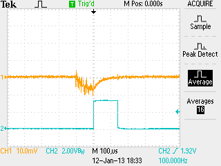

I'm trying to design a smart discharger for my batteries in order to determine their capacity and automatically shut off the discharge when the batteries go below a certain voltage. In my course of preparing the software and hardware, I realised a very interesting phenomenon across the various analog channels available in the Teensy 3.0. As I need to be able to accurately compare the voltages at different points in my circuit, I needed all of the ADC channels to be matched. I built a simple circuit such that I connect a single battery across every analog channel (A0-A9), measured their ADC values and plotted a frequency histogram of the data. The numbers are quite interesting:
The frequency histogram may be more telling:
From top view:
Notice that moving from channel A0 to A9, there is an offset in the "earlier" channels compared to the rest. The channels start to be more matched in terms of their output starting from A1. However, channel A0 is offset by at least 2 ADC values compared to A1-A9. Therefore, if you need matched ADC outputs, seems like channels A1 to A9 are better suited and A0 should not be used. For more critical applications, seems like channels A5 to A9 are very well matched and A1 to A4 are also well matched.
Further more, when I connect the ground of the battery to AGND, I'm getting a lot of noise on the circuit (the ADC values generated above are based on connection to AGND). From the values above, the variance is in the region of around 7 ADC units (using a resolution of 12 bits). However, when I connect to GND instead of AGND, the variance is around only 1.5 ADC units. So which ground reference pin should I be using in this case? Also, I have also tried to connect a 1uF capacitor across the ADC channels to ground for the analog pins that I'm reading. Is that a good practice and recommended?
