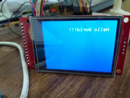

Hello All,
I'm trying to interface a 2.4" TFT SPI 240x320 display with a Teensy 4.0 microcontroller. The pin connections follow the setup described in the link below, except that the CS (Chip Select) pin is connected to pin 9, and the DC (Data/Command) pin is connected to pin 10.
I'm using the following code, but the text on the display appears mirrored, even though the rotation is set correctly and also The background color isn't displaying properly — I'm using fillScreen(RED), but the screen shows blue instead.. Can anyone help me figure out what's causing this and how to fix it?

what version of teensyduino and what IDE are in use?
Try one of the examples included with the library just to be sure the behavior persists.
I'd close the IDE and restart using one of the examples like:
"T...\hardware\teensy\avr\libraries\ILI9341_t3\examples\graphicstest\graphicstest.ino"
There may be a badly compiled file in the TEMP build folder.
Also with Verbose build at the end the actual library in use is noted and it should link to the one in the TeensyFolder and not a local library copy - something like this (as shown using path for IDE 1) - there is will come from the USER APPDATA LOCAL folder (windows?) but the BOLD TAIL shown and version should be similar:
Using library ILI9341_t3 at version 1.0 in folder: T:\T_Drive\arduino-1.8.19\hardware\teensy\avr\libraries\ILI9341_t3
So, this is the location where all files are saved C:\Users\SMDDC2\AppData\Local\Arduino15\packages\teensy\hardware\avr\1.59.0\libraries\ILI9341_t3\examples\graphicstest
I uploaded the graphicstest.ino available in the above path, again everything is displayed in inverted

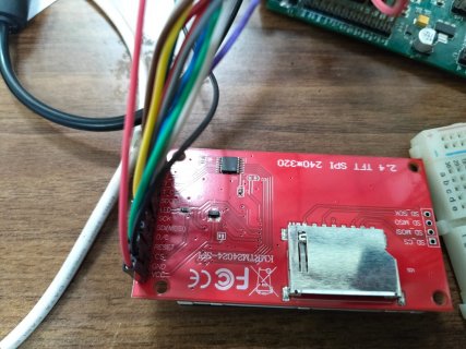

Something odd about the display there it seems. Not the same or using the same actual interface chip.
AFAIK this hasn't shown up in the years this display has been in use.
Is only a single copy of this display there to test?
Compare the visible markings on the PJRC page - and maybe upload a phonto of the backside not showing on that page.
I already uploaded backside of the display in the top
indeed :)
That is 2.4" - the handy ones here are not 2.4" so not clear that may not have a different controller that ILI9341. SImple variations can show big differences.
PJRC suggests 2.8" or 3.2" were the common sizes used when ILI9341 code was tested

So, got this issue sorted out. In case, in future if anyone had this issue, modify the ILI9341_t3.cpp file.
look for setrotation function
switch (rotation) {
    case 0:
        writedata8_last(MADCTL_MX | MADCTL_RGB);
        _width  = ILI9341_TFTWIDTH;
        _height = ILI9341_TFTHEIGHT;
    case 1:
        writedata8_last(MADCTL_MV | MADCTL_RGB);
        _width  = ILI9341_TFTHEIGHT;
        _height = ILI9341_TFTWIDTH;
    case 2:
        writedata8_last(MADCTL_MY | MADCTL_RGB);
    case 3:
        writedata8_last(MADCTL_MX | MADCTL_MY | MADCTL_MV | MADCTL_RGB);
In this function change the instances of: MADCTL_MX | MADCTL_RGB
to: !MADCTL_MX | MADCTL_RGB

There are variants if the ILI9341 that are basically compatible but require a slightly different initialization sequence.
TFT_eSPI handles these, so I would look there in Bodmer's defines - the init and rotation headers for the ILI9341 variants and you should find the sauce.
