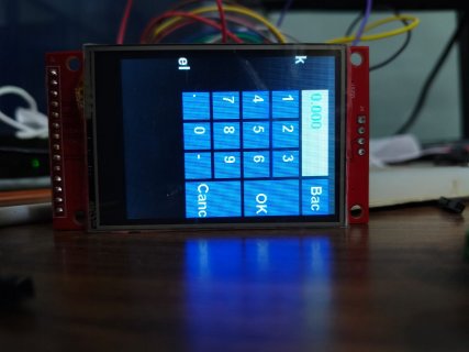

Hello Sir,
I'm currently unable to access the updated version of the library, so I modified the .h file from the existing example provided in the ILI9341_t3_Keypad library. However, I'm facing a couple of issues:
  • The keypad layout appears misaligned on the screen.
  • The touch detection is inaccurate — for example, when I press 9, it registers as 6, and pressing 5 returns 8, and so on.
Kindly suggest how this can be resolved.

You need to get the latest lib. Amongst some fixes, I've added a routine to calibrate the display touch coordinates.
