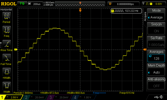

I'll have to make a decision on audio DAC vs mine.
I need the precision for the pitch CV —*and I'm happy with the one I chose for that.
The reason for thinking about audio is that I'm doing some funky pitch bends. The other CV out is going to be used for envelope.
Regardless — I presume I can do "audio" just at a lower rate —*which is probably enough.
My not-based-on-anything calculations — each write is 24bits — @ 44100Hz it only needs a couple of Mhz if it was streaming out bits.
Looking at the oscilloscope this evening, a sine wave at 523hz has 33 or so points.
Which indicates about 17khz update?
