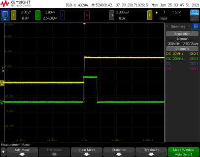

I'm trying to precisely set a clock from a cheap GPS unit with PPS output on a Teensy 3.5. I have the code apparently working and in manual comparisons (pressing a button while watching a clock) to a real time source it's very good and clearly is using the PPS appropriately.
I am using the elapsedmillis() function to graft on milliseconds to the time by taking a baseline value immediately after setting the clock (which in turn happens immediately after the PPS pulse starts)
However as part of proper testing I have an Intervaltimer configured to pulse an output pin on 0 milliseconds (actually on 1000000 microseconds basis - heartbeattime=1000000)

I have a put both the PPS on the GPS board and the digital out pin on the Teensy3.5 into a scope and while I would happily accept there could be delays in my code meaning I might observe a static offset of the PPS high and the Teensy pin high, I didn't expect to see the Teeny wander away at the rate it is.

the video above seems to show a significant drift in the IntervalTimer, that's my specific question - is that expected?
No. This much drift is not normal. Timing is based on the 24 MHz crystal, which should error less than 30ppm.
Is there a way to discipline the timer used for that?
Directly in hardware, no. With carefully crafted software, maybe, probably.
But adding even more complexity to this code described as "ugly++ at the moment" and too much to share here on the forum would really be putting the cart before the horse. You should first create a much simpler program to investigate only this issue.
I'd recommend starting fresh with code using repetitive calls to digitalReadFast() to detect the rising edge of the 1pps pulse. The moment you see a low then a high, start an IntervalTimer with 1000000 us period, and have it run that function which just pulses another pin. Do this only once in setup(), and put no code at all in loop(). Just let the IntervalTimer keep running the pulse function every second.
Then watch the 2 signals on your oscilloscope. Obviously there will be some lag from the rising edge to when IntervalTimer runs the pulse function, but it should not drift much.
That code should be very simple and something you can easily post here on the forum....
Ok, I tried it here, and indeed I'm seeing the problem with this simple program. Maybe we have a bug in IntervalTimer?

Here's a video of the exact same hardware setup running the code you supplied Paul... Also, why are you subtracting 14.2 from the intervaltimer micros metric?

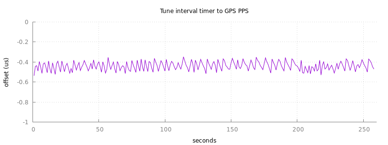

Here are T4 results from steady-state run of tuning sketch with NEO-M8U GPS with external antenna. Drift of this T4's 24MHz crystal is -11 ppm.
Offsets have small deviation, but not centered on 0?
Using mytimer.update(period - err * 0.20); // proportional control
