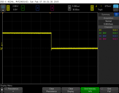

In a perfect world I'd expect to see at output pin a signal looking like this:

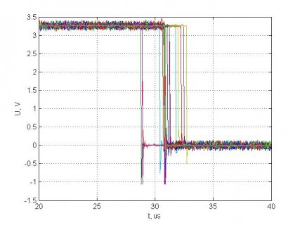

I checked the real life output by connecting oscilloscpope to the ouput pin and recording waveform a few times.
What I saw is like this:

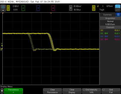

And here is zoom of the zone around the first drop:
As one can see, sometimes timing is off up to about 3 us which is 10% of my sampling period and is not acceptable.
Am I doing something wrong?
How can I get more precise timing?
Thank you!
Thank you!
