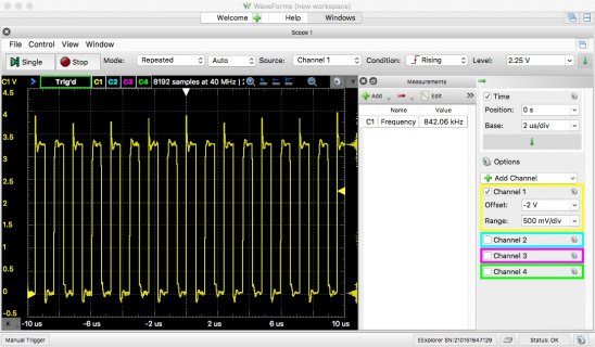

Looking at the code, the output on pin 14 should be a squarewave at 1/2 of the interrupt rate, and it is... Here we get 315.8 kHz, for an interrupt rate of 631.6 kHz. Not bad at all.
Here is the output on pin 14, seen using a Digilent Electronics Explorer:

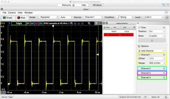

Here is where it gets interesting. The same code, on a Teensy 3.6 overclocked at 256 MHz works down to 0.6 us (!!!!!), which is way faster than the Teensy 4.0. The output (shown below) is a 842 kHz squarewave, corresponding to an interrupt rate of 1.68 MHz. Now that's cooking.
So... What is going on here? I've read all of the threads on the F_BUS stuff, but at the end of that, it seems like there is a big opportunity here. If someone could take a look at IntervalTimer to see if it can be optimized for the Teensy 4.0, I (and I suspect a lot of others) would be very, very grateful.

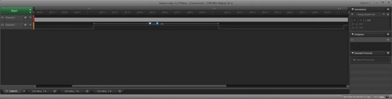

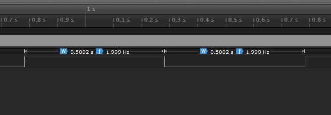

Thanks @luni,
As an experiment, I edited the header file to check for 23...
Ran a simple test case:
#include <IntervalTimer.h>
IntervalTimer my_timer;
uint32_t count = 0;
uint8_t led_state = 0;
void isr () {
  digitalWriteFast(2, HIGH);
  count++;
  if (count == 1000000) {
    led_state = led_state? 0 : 1;
    digitalWriteFast(13, led_state);
    count = 0;
  digitalWriteFast(2, LOW);
  asm("dsb");
  pinMode(13, OUTPUT);
  pinMode(2, OUTPUT);
  while (!Serial && millis() < 4000) ;
  if (!my_timer.begin(&isr, 1)) {
    Serial.println("\n*** timer begin failed ***");
    while (1) {
      digitalWrite(13, !digitalRead(13));
      delay(125);
And I am getting the LED turning on/off every second... But the LA is showing it reasonably...

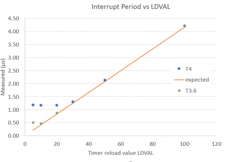

I also did some experiments.
Changed the code in intervaltimer to ignore the limit and printout the calculated ldval. Get the following
LDVAL  measured period
1	   0.5
11	   0.5
21	   0.91
47   	   2
479	   20
So, good thing is that the current code is faster than the code in the beta tests it now saturates at 0.5µs.
Frank did experiments with changing the clock in the beta thread. It improved the situation a bit. But, be aware that if you increase the clock maximal delay will decrease accordingly. @150MHz you get a maximum delay of 1/150MHz * 2^32 = 29s.

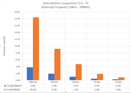

Did another experiment to quickly check the load. With 4 timers you can go down now to 3µs period before it overloads. This is also better than the 100kHz couple of month ago...
IntervalTimer t1, t2, t3, t4;
template<unsigned pin>
void callback()
  digitalWriteFast(pin, HIGH);
  delayNanoseconds(200);
  digitalWriteFast(pin, LOW);
  while(!Serial);
  Serial.println("start");
  pinMode(0, OUTPUT);
  pinMode(1, OUTPUT);
  pinMode(2, OUTPUT);
  pinMode(3, OUTPUT);
  pinMode(LED_BUILTIN, OUTPUT);
  float p = 3.0f;
  t1.begin(callback<0>, p);
  t2.begin(callback<1>, p);
  t3.begin(callback<2>, p);
  t4.begin(callback<3>, p);
  digitalWriteFast(LED_BUILTIN, !digitalReadFast(LED_BUILTIN));
  delay(100);
