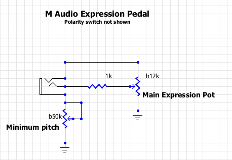

Hi, I'm adding an expression pedal port to me midistomp pedal so I've done a little test sketch based on an analog pot example sketch. I know some expression pedals are inverted, some have a polarity switch, and some don't.
Two questions:
1. Is there are better way to write this code? (don't want it to be too messy)
2. Can you show me how to make a user-editable 'virtual polarity switch' which will invert the midi range so it would read 127 to 0 OR 0 to 127 ?
Thank you
