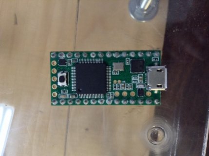

I can't seem to get a usage picture of the Teensy up close. My iPod Touch and tablet both ended up with crappy cameras (regardless what people say about the Touch 5G's or the Transformer's cameras... I must have gotten poor hardware), and none of my real camera's lenses support "close enough" macro.

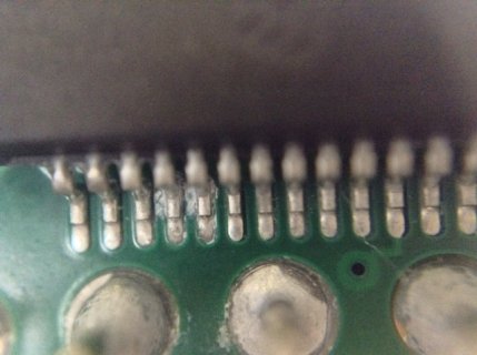

I used a "phone camera to microscope" adapter someone at the local makerspace built and grabbed a picture of some crystalline stuff under/between the pins of the mk20dx256 chip:
Here is the Teensy from above, and as close as I can get while still being able to get it in focus:
I don't know if that crystalline gunk was there when I got the Teensy or if I somehow managed to deposit it there myself. My assumption is that it is flux left over from soldering. I went over the header pins with an alchohol swab to try to clean off the flux in the solder I used (which is where all those little cotton fibers came from).
Can this stuff cause the problems I am having?

BTW, counting clockwise from the "dot" denoting pin 1, it appears that the flux is between pins 28-30.
Edit: clockwise is apparently the wrong direction to count, so it is actually pins 35-37.

I found some 91% isopropyl alchohol and a clean toothbrush, so I soaked and scrubbed the Teensy's mk20dx256 IC to get rid of the pictured flux crud. When I was looking over the board after letting it dry a little bit, I noticed that the MINI54 IC had some pretty heavy flux crud between several pins on the header side and the side opposite the headers. I may have managed to get the flux on the pins next to the headers, but there's no way I got it on the ones on the opposite side of the MINI54.
I've cleaned off all the flux I can find on the mk20dx256 and MINI54, and I haven't been able to find any on any of the other ICs (other than some on the end of what looks like a capacitor). I've soaked and brushed the whole board, though, so I'll see if the Teensy works after letting it dry for several hours in the fridge.

Good news. It appears that the alchohol bath+scrubbing has worked!

It is possible that the solder may have had a reaction to the flux and did in fact "grow". When the world decided lead was bad for electronics the choices for solder are not so great. Some of the replacements have issues such as tendril growth over time. This is caused by some reaction of some sort and may be accelerated by electrical stimulus (not sure on that). This tendril growth will have the affect of making electronics have long term usage issues. This is one reason medical equipment is exempt from ROHS. I am sure someone has formulated better solders since then, but it is still a possibility. So my guess is it could have tested fine, but maybe because of the flux residue it was enough to fail over time do to some chemical reaction.
FYI:
http://en.wikipedia.org/wiki/Whisker_%28metallurgy%29
After I had soldered the headers to my Teensy 3.1, I eventually found that there was some crystalization between the pins of the MINI54 IC. It is the second-biggest chip on the Teensy 3.1 if I remember correctly, and it is very close to the micro-USB port. If you have an eye loupe that is 4X or better (actually, 2X or 3X might even be enough), you should easily be able to see any flux crystalization between the pins of either of the chips.
The solder I had been using was the lead-free stuff that I bought from Adafruit (if I remember correctly... it might also have been from Sparkfun, but they both likely sell the same type of lead-free solder). It is a rosin-core solder, if I remember correctly. In any case, the 91% isopropyl alchohol we keep in our medicine cabinet worked really well with a little bit of "elbow grease". After finishing with the scrubbing, I put the Teensy in the world's greatest electronics dryer, my refrigerator, where the fan would blow on it. I let it sit in there for an hour or so to make sure that there wasn't any water left underneath any of the chips, the micro-USB jack, headers, or the reset button.
Once it was dry, it started working properly, and it has worked ever since. :)
