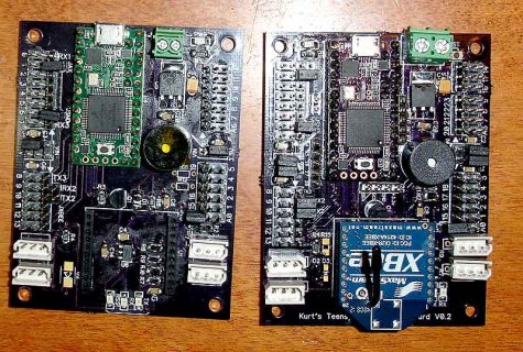

As I have mentioned in a few other threads, for the fun of it I have built a fabricated a couple of different carrier boards. On the 2nd version of the first one, I did add an SMD adapter to the bottom of the Teensy, such that I could get those extra IO pins. Note: Did not find exact part I wanted (2x7), but Digikey and others carry the 2x8 versions, which you can then clip off a row of pins. Digikey part number I used is: TSM-108-01-TM-DV-ND
Slightly off the topic, but here is a picture showing the first board:
The purple one is the slightly changed 2nd generation, with a Teensy also from OSH-Park.

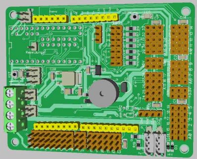

I couple of people on another forum were interested in one that also supported Arduino Headers, so I continued to play around with Diptrace and since it only costs about $30 to get 6 of them from Seeedstudio I decided to try one out and just put in the order today. It looks like:
It is a bit bigger than the other one and does not have an XBee setup, but just having some fun. Sorry for a slight hijack

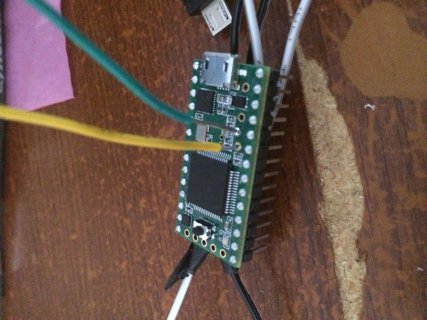

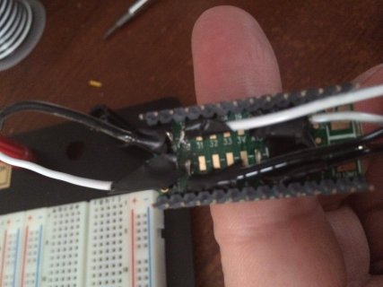

I went ahead today and woke up with the intention to either succeed or destroy 20 dollars; and I may say that I was decently successful!
I was able to solder A10 and A11, then I went ahead and did A12, A13, A16, A17, A18 and A19. Except a mess caused by me shaking the iron, and dropping a glob of solder on top of the board (god bless solder wick!), I was able to make decent junctions; altho I can't really tell if they are good or not for the long run...looks horrible but overall seems to be able to grab the analog signal from the sensor.
The down side is that I probably burned the LED, since it won't turn on anymore, but the board seems to work (tried few sketch and the serial port is returning the data); if I damaged something else, I have no idea...guess I will find out once I try I2C and try the other mode of the board (in particular I will need USB HID, since the Teensy will act as USB peripheral to drive the sensors).
Attached few pictures to show what I did. I simply tinned and soldered the wires on the plates, then I had to cover the exposed part of the wire with electric tape, since while soldering, I burned also the wire coating, exposing the wire :)
