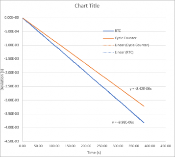

To my knowledge the the RTC crystal is not temperature compensated.
Here some test code (T4.x) which prints the drift of the RTC crystal and the drift of FCPU relative to a GPS pps signal (1Hz). The pps signal is connected to pin 11 and triggers a pin interrupt. The corresponding ISR reads out the RTC counter (see: https://github.com/TeensyUser/doc/wiki/The-real-time-clock#reading-out-the-rtc) and the cycle counter (see https://github.com/TeensyUser/doc/wiki/Using-the-cycle-counter), transforms both to seconds and prints out the difference to the 'real' time (GPS time).

Here the resulting data printed against time:
-> My RTC crystal drifts with about 10ppm, the main clock with about 8.4ppm relative to the GPS signal.
You can use the code above (either RTC or cycle counter) to generate your time stamp if the accuracy is good enough for your application.
