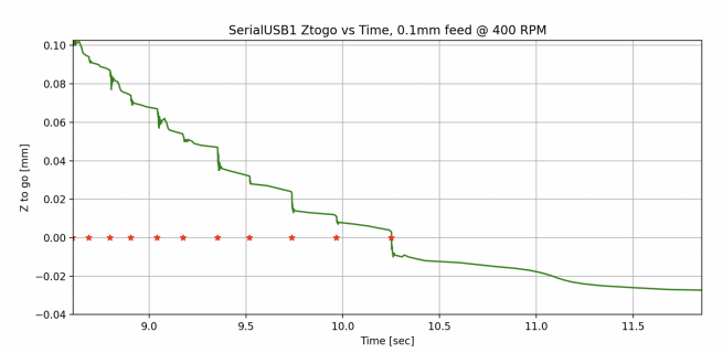

Hmm, well it took me a while, but I finally got what I wanted. Extracted the data and plotted a high resolution view of the position of the z axis of my lathe simulator vs time, using the ARM cycle counter. Had to compensate for the rollover of the 32bit counter, several times. Test was about 31 seconds long. I log every time the Z position moves, to a 1um resolution, over 10mm of travel. The velocity is logged on SerialUSB2, and the position on SerialUSB1, along with logging the time stamp of the start of the step pulse. Mechanical things sure do weird stuff, when you look at a 1 micron scale. Red star is time stamp of the step pulse to the stepper motor driver. It seems that last step pulse probably shouldn't have been generated, as I stepped past the stop point of 0.000 mm. This is why I wanted the logging ability, to visualize what was happening.

Can't sort (yet) because the uint32_t timer timestamp is rolling over every 7 seconds, so that needs to be corrected first. Since this is a 30 second long log, it needs to be corrected at least 4 times. Need to look into a 64bit cycle counter. I'm using a Mac, so I have access to some of the tools you mentioned.
Right now, I'm not dealing with that level of mechanical or thermal effects. First trying to get the carriage to move as I want. It's proving to be tough to stop on a dime, ie. within 1um. This is for feeding the lathe carriage and stopping precisely at a point. Compensation for thermal is different. Technically, one would need to know the temperature of the work piece, and that's not going to happen.
My (ongoing) project is not for a CNC lathe, so I'm not dealing with multiple axes. I am controlling the Z axis, although I have position information (1um resolution) for both the Z and X axes. Z is the direction along the spindle axis, X is the cross slide axis, in the horizontal plane and perpendicular to the spindle axis.
All of this is a feature I call feed to stop. Eventually I hope to add thread to stop. Already have feeding and threading working (for over a year and a half). I can make any metric or "imperial" thread or feed I want at the touch of a couple of soft keys. My ELS (electronic lead screw) controller shows the DRO (digital read out) positions, thread or feed information and spindle RPM. It's purpose (for me) is to be a smart manual lathe, not a CNC machine. So some controls depend on operator interaction, same as a manual machine. The idea is for the operation to be familiar to a manual lathe operator, but have enhanced functions. I've cut threads in steel from 4 threads per inch to 40 and they fit perfectly. Same for metric threads. To date, the ELS has worked far better than I anticipated. Hopefully, this feed to stop will exceed my expectations as well. Been a lot of work though!
