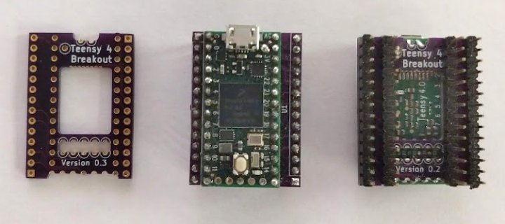

Yesterday I received two packages in the mail, (a) more T4s to destroy, and (b) samples of FRDM4236's board. So I got to work and assembled two of my slightly modified (stretched) versions of Blackketter's board, and one of FRDM4236's board. The good news is that all three worked immediately with no need for rework, and all have been tested for read and write on all 40 GPIO pins. Fantastic!
After just one evening of working with both these breakouts here are some impressions:
1) They are both useful and neither one is better than the other. they are different and serve different functions. I want to have both in my toolkit.
2) I am now a convert to the use of castellated through holes for attaching to underside pads. In the past I've insisted on installing female headers (on loglow's T3.x breakouts) so that the Teensy could be simply unplugged, thus avoiding a major rebuild if something went wrong (which it too often did). With these new breakouts construction is fast - less than 20 mins - and I have no qualms about committing a T4 permanently to the breakout.
3) Soldering to the castellations is easy and nothing no be afraid of. A tiny bit of non-corrosive flux, a narrow tipped iron, plenty of good-quality soldering braid (I use MG brand - there is a lot of junk out there), and you're good to go. Don' panic if you do get a few solder bridges, that's where the solder braid comes in! Just be quick, and don't let the iron dwell on the pads more than is absolutely necessary. Practice with a cold iron to get the tip angle right to contact the the castellation and the pad.
The Blackketter Board:
a) This might be called a bare-bones breakout because it has no additional components or sockets, and simply exposes the hidden T4 pins in two extra 14 pin columns beside the T4 pins, giving a total of 56 pins. The order of the pins around the board seems somewhat random, (chosen for ease of PC board layout), and you may need to keep a list handy.
b) Because of the adjacent columns of pins this board cannot be used in a breadboard, and that might be a problem for many users.
c) I've built four of these now. Assembly was easy, with no soldering problems. Only the very first one showed any functional problem, where a single pin is held high, and measures about 6.7 kohm to +3.3v. The rest of that device seems to work fine, and the other 3 units are fully functional on all GPIO pins.
d) Just my personal taste, but I like the form factor of the "squat" 14 pin height for fitting to my prototyping boards, and for now I think I will continue to use these breakouts.
Aside: I've mentioned previously that for prototyping I use Velleman Eurocards, which are basically FRP 0.1" perf boards with Cu plated horizontal "islands" on the back, and they come with either 1, 2, or 3 holes per island. They are good quality, and I've never had a problem with a pad lifting from heat. The standard Blackketter board only works with one hole islands, whereas I only work with 2 or 3 hole islands. My solution was to use KiCad PCB software to stretch the board in width and include a gap of 0.1" between the two pin columns on one or both edges. The photo above shows the single gap version. However, I found after I built this board (which only works on two hole islands), the the double gap version actually works on both 2 and 3 hole islands, so that's all I be purchasing in the future!. I've had these built successfully in 1.6mm FRP at OSHpark (but not 0.8mm - which was a disaster, as several on this forum found out :mad:).

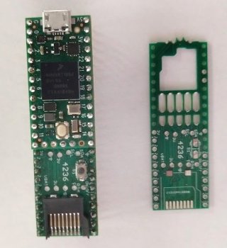

The FRDM4236 Board:
This is a nicely designed board that creates a breakout in the form factor of a T3.5/T3.6, ie a DIP package with 24 pins/column - totaling 48 pins. The 20 additional pins are allocated for GND, +3.3V, 16 GPIO pins, and two unused pins. The additional GPIO pins (24 - 39) are laid out in order around the board) Across the center of the board are two rows of 5 through holes, one for an I2C OLED display, the other for access to the Teensy pins PRGM, ON/Off, VBAT, GND.
The is a mounting area for a microSD socket. an ON/OFF tactile switch and some SMD components (for the SD card only).
a) This is a very useful general purpose breakout, especially for use with a breadboard, and there is no reason why it cannot be permanently built into a project.
b) The current boards are fabricated as 0.8mm PCBs. Assembly was easy (but read the instructions carefully). FRDM4236 has taken care to make soldering the castellations easier by creating physical barriers between adjacent solder points. No problems once you realize that you have to hold the iron at a steep angle. in the slots. FRDM4236 has been quite clever about the design of the castellations for the 1mm pads. He has made it such that there are small "peninsulars" between the pads to minimize solder flow.
c) The unit worked flawlessly from the initial power-up.
d) There is a problem however. There is no way to switch the power source between VUSB and Vin. As with any T4, Vin is wired to VUSB unless the jumper is cut. On this board there is no provision (or any available pin) to put an SPDT switch or three pin jumper header. (Loglow's boards allow for a switch or header to be soldered on). If you apply voltage to USB while an external source is connected there is a serious risk of damage. I cannot see a clean way to fix it here.
My recommendation for any redesign would be to modify the power connections, use the two empty pins for something useful - my vote would be for VBAT and ON/OFF, and perhaps get rid of the OLED pins and that second row of through-holes.
Will I buy more in the future? Absolutely.

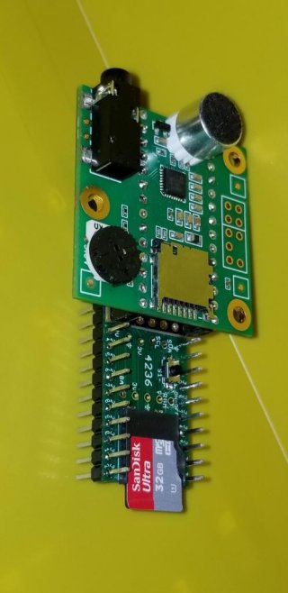

FRDM4236 sent me a board - now assembled to an OSHPark Purple T4.
I used tall pins so the bottom female header PJRC Audio Rev D board could be attached.
I did the DMM test and found no shorted/bridged SDIO pins!
Board was not washed - only flux used was from solder core - but after doing each group, before flux got cold, blotted with a paper towel
> Powered up to Blink - opps I had not even powered the Purple T4 before soldering.
> Ran the CardInfo test for T4's BUILTIN_SDCARD, then moved same card to Audio board and it also worked with chipSelect = 10
> Ran Audio sketch ToneSweep and that worked to headphones.
> Tested the FRDM board's POWER button to work OFF and ON
>> Ran test code from loglow board thread (see below) to set all pins PullDown and show when change from LOW ( hit 3.3V on each pin ) , and then PullUp and show when change from HIGH ( hit GND on each pin ):
- No shorts between pins, all pins read Zero or One as expected!
<edit> Here is the Hi Low test sketch. Run it with SerMon active and read screen notes.
View attachment HiLowTest.ino
> Start with a 3.3V wire and touch in turn to each digital pin, watch for single pin change to 1 and 0 on release.
> hit SerMon ENTER to change mode
> Change test wire to GND wire and touch in turn to each digital pin and watch for single pin change to 0 and 1 on release.
** Pins out of sync on test start or after Enter - stuck in wrong state will be shown.
>> Pay attention to GND and 3.3V pins and never touch VIN 5V pin!
More to test - but those are the hard parts?
Soldering was straightforward and error free. I did a quick wipe or two with Solder Braid to make sure the SDIO pins were safe - and to get some off the tall pin tops so the female header could seat.
Going to solder a short female header on the i2c pins and got an SSD1306 that will fit there.
It looks like there is clearance to audio board for the 0.5" Heat Sink in use
>> Looking forward to ordering the USB_HOST capable version of this board … will wait a couple of days for the new design to settle.
Soldered on the short female header for i2c. Put on new style SSD1306 with the same pin order ( older/common ones had VCC/GND swapped )
Using Adafruit test code with Wire it is running well on this FRDM4236 board - using those provided mid board pins!

NOTES ON {pt 2}: Teensy 4.0 Ultimate Breakout Board:
Found a 12V supply to external USB HDD bay with a fitting connector (not sure of what size is common - but I have 3 non fitting}:
> USB to PC was powering - showing Yellow VUSB power
> Sometimes - plugging external power maintains the VUSB Yellow?
> Unplug both and plug external and get BLUE VIN power
> Plug in USB and it stays BLUE VIN - expected - perhaps it depends on which is higher 5V?
> Unplug External 12V and Blue VIN stays lit with VUSB? Changed when toggled USB Host switch?
> MidBoard chip 'regulator' Hot to touch with 12V external power - it reads 124F or 51 C - nothing connected or soldered to PCB
External power is 12V 3A supply - USBHost Lan Test:
> Upload Ethernet LAN USBHost dongle code - at 600 or 816 MHz - which should work without heat sink.
>> With USB power and External connected with upload it does start - or USB alone as expected
{ Have USB connect dongle with 5v line switch to cut power but leave data and GND to PC }
>> Remove 5V USB power and powered from Ext VIN - T4 restarts/goes offline - will not run from onboard LDO with 12V input? Button will not take to Bootloader?
When running from USB power - switching OFF HOST power the LAN USB dongle shuts down and then when switched on it reattaches to the network. So that says the PCB and USB on USB power are all good, something about running from External VIN with this 12V supply, which as noted is for a long working external USB bare SATA drive connector box .
>> Found another 12V 1.5A supply with fitting plug that has the same behavior. Upload and run with VUSB and VIN it works. Cut the 5V VUSB line and the unit restarts or shuts down in some fashion. At this CPU speed the Host supplied VUSB it always enough.
- reading the Tindie doc it says 300 ma max at 12V - it is running at 600 MHz - just dropped to 528 Mhz and same result. And when VUSB is cut the LDO quickly goes too hot to hold a finger on. And I see the NOTE - Yes the Jumper is 'PREREG' - I wondered what that was for. I was hoping the external supply would be enough to drive even heavier USB Host loads - like a HDD which never work from Host Usb power through Teensy, where the LAN can.
