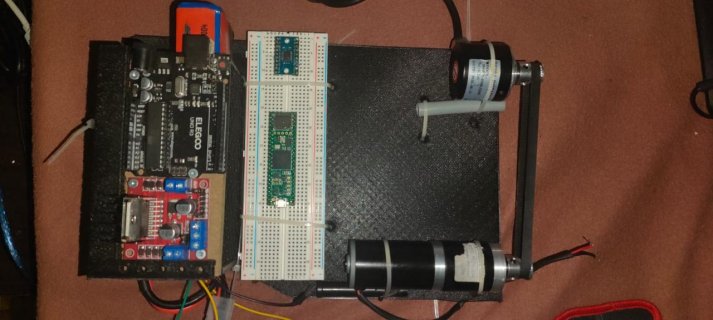

I just recently began using Teensy, and I'm happy to say that I'm a Teensy 4.1 user. However, I am having a lot of problems, which I am gradually resolving with the assistance of the knowledgeable experts present in the forum. All of you are appreciated.
In order to explore the terrain, I'm currently building a skid steer rover that interfaces with ROS. The system uses the Odometry information to locate my robot. For each side of my rover, I therefore initially intended to use two inexpensive Rotary Incremental Encoders with a resolution of 600 PPR.
I attempted to use an Arduino, but there were many restrictions, such as its clock speed, interrupt pins, RAM and many more I'm giving Teensy 4.1 a try. I'm testing out using a Teensy to control a motor like in the image below.
I first tried publishing my data and interacting with Arduino. Given how computationally intensive my code was, it didn't work all that well. The encoder has a 5 to 24-volt rating. Motors can run at a maximum speed of 24 RPM, which is not very fast. I discovered that the teensy's pinout can withstand 3.3 volts. I tried to connect a TXS0108E Level Shifter that I had purchased, but I was unsuccessful because there were no tutorials available specifically for encoders. I want to know if I can use a 5V encoder on a teensy (specifically the 4.1 board).
Also, if I use a logic level shifter, will I miss any pulses between them?
Thank you very much, everyone. I would appreciate all your help.

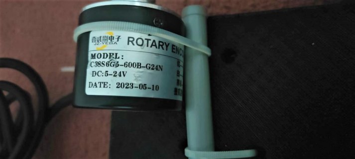

Do you happen to have a partnumber of the encoder on the photo?
Paul
Can you provide a link to the datasheet for your specific encoders? Most encoders are open-collector specifically to make it easy to use, which may explain your troubles with the level shifter.
https://forum.pjrc.com/threads/70595-5v-encoder-(600PPR)-for-JOGWHEEL
I think this thread should work. The part number can be seen from the attachment in this message (c38s6g5-600b-g24n). Since, its not produced a very renowned manufacturer, I dont know if the datasheet is accurate. However I have attached the one I found online. You can take a look at that as well.
I need some help setting up my level shifter too. I dont know if the level shifter I bought (TXS0108E) should work in my case. Let me know if I need to buy another level shifter of a similar type or a different one.
Amazon Link for the Encoder: https://a.co/d/31UQkXz
Datasheet: https://drive.google.com/file/d/1NpaKxo0ttTe46B03Aze6b3us8Ulb8psq/view
  • Photoelectric Incremental Rotary Encoder.pdf
I'm 99% sure that this encoder will work when hooked up as indicated in that thread. No need for a level-shifter, just use two 1K pullup resistors to 3V3 and the two pins on the Teensy 4.1 you are planning to use.

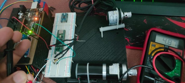

I actually forgot to mention something. I used another Teensy 4.1 and I just connected my encoder outputs directly to the interrupt pins of the Teensy as I was not really aware of this before. I did that because it seemed to work well with Arduino. I ended up burning the board I guess as I noticed the board just started heating up (LED Pin heating up) and it was not recognized by my IDE. I assumed that the pulses were 5v as the encoder was powered by 5v and gnd. This is the only contradiction I am still unclear about. Did my teensy stop working because of this or it stopped due to any other connection error? I know you really cannot comment about it but still I was wondering how it burnt the board when the pulses were less than 1v in all my 15 readings I tried to take with a multimeter.
5V can destroy Teensy 4's (either immediately or by cooking in CMOS latch-up). But that encoder says its NPN open-collector and you only measured 1V max on the output... Bit of a mystery.
Did you double check all the connections before powering up?
If I wasn't sure I'd have added 1k in series with the encoder outputs to limit the current, as that may spare the input protection diodes and will prevent latch-up.

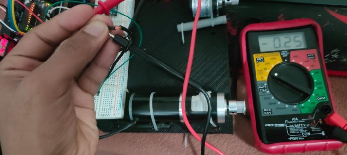

Sounds like something is clearly wrong with your hardware. The signal should be close to 0 volts when low, and something like 3.3V or 5V when logic high. Getting 1V is clearly not right. Maybe it is damaged or defective. Maybe it is connected incorrectly, either by a mistake or misunderstanding. Or perhaps both, maybe even damaged by a prior mistake and now not working when connected correctly?
Please understand diagnosing hardware problems remotely over the internet is difficult at best. But so far, this conversation is far from a best case. We can't see how you've actually connected the parts (eg, photos or clear diagrams). Written descriptions of what's been tried and how results were measured lack detail. So far most of the answers written here are detailed descriptions about how to use encoders, rather than directly troubleshooting your specific problem, because we just don't have much specific info. We're all trying to help, but given so little to go on, this is the best anyone can do.
I would highly recommend showing photos. Try to capture multiple angles, with a couple wide shots so we can see the whole system with all wires, and close ups from a few angles so we can see how the wires really connect. Show all the details, without over-thinking whether they are important or mundane. Often the real problem is something you've overlooked or not anticipated. The better you can show us everything, the higher the chance you'll end up capturing in a photo some key detail you may have overlooked... which we might be able to notice.
Over and over on this forum we've helped solve electronics wiring problems. Misunderstandings are usually the hardest without photos, because if you explain what you've done with only words, usually those words will sound correct. But if there is a misunderstanding about the meaning of those words, the wires and parts might be connected differently than everyone imagines based on their understanding. Only photos really help in the case of a misunderstanding.
So at this point, I really have 2 suggestions. #1 - Continue testing with only a voltmeter and don't risk destroying a Teensy until the signals are confirmed correct, and #2 - Pour your effort into trying to actually show us what you've really done and the results you're actually observing. We can help better when we actually see the problem.
For a good example, look at msg #6 from PaulS on that other thread.
His photo shows the encoder with part number visible. Some of the wire is outside the view, but we can clearly see the end of the encoder cable with 4 colored wires. We can see the solderless breadboard from a good angle where the place all 4 wires really connect is easily visible. Two resistor are present and the place they connect is easy to see. This is a good example of how to shoot a photo showing how a part really is connected. Now compare with the photo in msg #1 above, where we can't even see the end of the encoder cable or how any of the wires really connect.
Please let us help you. Shoot good photos like this example, so we can actually see how every wire really connects. If using a voltmeter, get it in the photo. If using power source other than USB, let us see what it really is in the photo. Details matter. Remember, the thing that is actually wrong may well be something you haven't anticipated or understood, so try to actually show us everything.
We'll try to help by bling guessing, but the help you can get here will be so much better if you actually show us the all the wires and let us actually see the results.

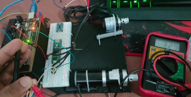

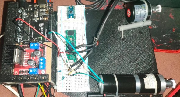

Connection:
5v Pullup:
3.3V Pullup:
No Pullup:
These experiments completely make sense now. The problem was due to the current that sunk into my gpio pins. The current measured with no pullup was the highest which was around 15mA in 15 readings and with a 1k Pullup resistors it did not go above 5mA. Please let me know if you want to know any additional details. If the above data is okay, I will proceed to connect my teensy and start my project with a 1k Pullup resistors. I was wondering if I use a 10k Pullup resistor, would that delay my signal or miss some pulses by any chance?
If I checked your picture right, you have a 38S6G5-B-G24N optical rotary encoder.
You should have mentioned the model number in your original post, because that would have saved everyone a lot of confusion.
38S6G5-B-G24N are optical rotary encoders made by various Chinese manufacturers, but they all do have open collector outputs.
With such an encoder, you only need a pull-up resistor from each encoder output to 3.3V. There is no need to use my circuit with these at all.
Yes. I suspect it was because the voltage was neither decisively "low" nor decisively "high", and floated somewhere in between. I don't know exactly what kind of circuit NXP used in i.MX RT1062 as an input, though, so it is just a guess.
Note that if you had say 38S6G5-B-G24X encoder instead, then the situation would be different!
If your encoder says 38S6G5-B-G24N on the side, then yes, you only need a pull-up resistor to 3.3V per output, and the circuit I showed would not bring any additional benefits.
If it says something else, let us know, and we'll find out together.
