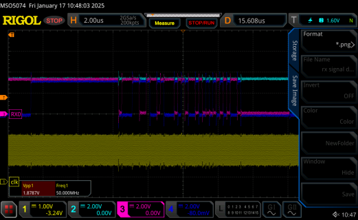

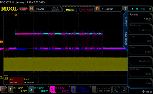

I’m trying to configure the ENET2 interface on the Teensy 4.1 to work with a DP83848 Ethernet PHY module using the QNEthernet library. Below is an overview of my setup and the issue I’ve encountered.
Hardware Configuration​
The pins I’m using for the ENET2 connection are:
PINENET2 FunctionDP83848 SignalTeensy 4.1 Pin
GPIO_B1_01ENET2_RX_DATA0RXD07
GPIO_B1_02ENET2_RX_DATA1RXD136
GPIO_B1_03ENET2_RX_ENDV37
GPIO_B0_12ENET2_TX_DATA0TXD032
GPIO_EMC_31ENET2_TX_DATA1TXD129
GPIO_EMC_32ENET2_TX_ENTXEN28
SD_B1_07ENET2_REF_CLKXICLK_SD
GPIO_B0_00ENET2_MDCMDC10
GPIO_B0_01ENET2_MDIOMDIO12
GPIO_B0_11ResetRST9
What Works​
  • MDIO Communication: I’m able to communicate with the DP83848 module via MDIO and configure its operational modes without any issues.
  • Reference Clock (50 MHz): I see a 50 MHz signal on the SD_B1_07 pin, which appears stable.
  • RX Signals: Using an oscilloscope, I can see clean signals on the ENET2_RX_EN, ENET2_RX_DATA0, and ENET2_RX_DATA1 pins.
The Issue​
The problem arises with interrupt handling:
  • I don’t receive any interrupts for IRQ 152 (MAC 0 Receive Buffer Done) or MAC 0 Receive Frame Done.
  • Even after reducing the Ethernet speed to 10 Mbps, the behavior remains unchanged.
  • I’ve checked my driver code multiple times and couldn’t find anything that might be causing this issue.
Summary​
I feel like I’m missing something obvious, but I just can’t figure it out. If anyone has experience configuring ENET2 on the Teensy 4.1 or has worked with similar setups, I’d greatly appreciate your insights!
Thanks in advance for any help or suggestions!
