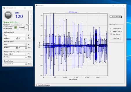

zenbob - on the PC can you close and restart the PC plotting app without disturbing the Teensy? Or at least resize it or make some adjustment that would leave it running but cause it to flush its stored log data for the signal?

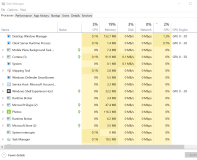

On your PC did you have TaskManager open to the Processes or Performance tabs and monitor GPU performance - if your PC has an active GPU unit? Paul will likely do that on his next run as it may show a spike to explain his fan powering up at the time of the stoppage.
If no GPU perhaps on the Performance tab with CPU selected right click on the graph and enable 'Show kernel times' - it may show increased activity.

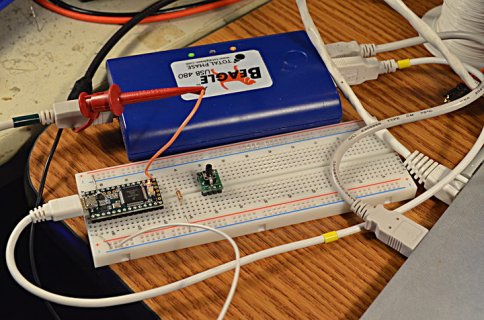

I'm starting another test, this time with the USB protocol analyzer and a frequency counter connected to pin 13.
When the problem happens again, I *really* want to see if this is still 4 Hz, or changes relative to what Windows sees.

Here's the test hardware.
The laptop is a 2011 Macbook Pro (i7-2760QM & 2.4 GHz, 8GB RAM) which dual boots between MacOS and Windows. It's running Windows 10, version 1803 (OS Build 17134.228)
My Linux desktop (i7-8086K @ 4 GHz, 64GB RAM) is running the protocol analyzer software to log all the communication, so the logging doesn't place any load on the Windows machine.
Did you find and enable the GPU column in TaskMan? Assuming the MacBook has a GPU unit to monitor independently that might show spike on that App.

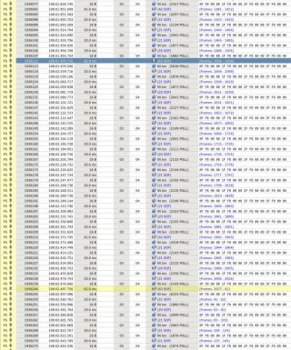

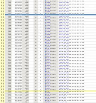

Here's what the USB communication looks like when it's working. This is after running about half an hour.
The 2 highlighted lines are the Note-off messages the code sends with:
  if ((gMIDI_Count + 18) % 24 == 0) { // 18 is 75% (of 24) gate time
    usbMIDI.sendNoteOff(67, 0, 1, 0);
    usbMIDI.sendNoteOff(67, 0, 1, 1);
    usbMIDI.sendNoteOff(67, 0, 1, 2);
    usbMIDI.sendNoteOff(67, 0, 1, 3);
    usbMIDI.send_now();
    //Serial.println(F("Stop Note..."));
If you look at the timestamps, 34:56.826.668 and 34:57.326.721, they're almost exactly 0.5 second apart. The timing looks very good.
Likewise, if you subtract any 2 timestamps from the many real-time clock messages (the packets with 0F F8... data), they're all about 20 to 21 ms apart.
Defragster - wrt to the monitoring app, it hasn't mattered if the app is running or not, or which app is used to monitor. In other words, for MIDI it doesn't seem to matter if we "consume" the data in Windows. Besides MIDIClock, we've used MIDI-OX and various Windows MIDI instruments such as DEXED and Arturia instruments to observe behavior. We've tried lots of permutations but the only thing with an observable effect is opening a serial terminal which causes it to recover briefly.
I'll check the GPU, but I haven't had it fail in the past two days. :confused: Going to try a reboot now. Oh, I just rebooted my music desk PC and it got the .228 update but my work desk PC hasn't updated.
Interesting - I was just keying off the fan speed rise from Paul assuming an app issue - it may have indeed been Windows that got overwhelmed given it happens with no app or other apps.

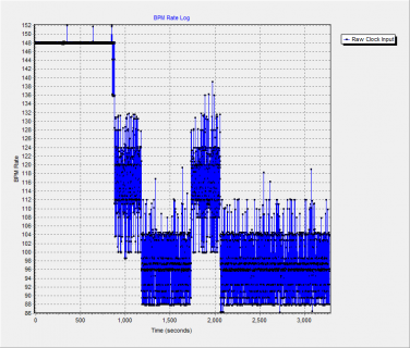

Ok, it finally started happening. Something is going very wrong. Looks like it may be on the Teensy side.
I'm going to add some more hardware (and restart the test all over again) to dig into interrupt timing with my scope.

I finally got a fail again, nothing to speak of wrt the GPU or other utilization. So I did the reboot test, Teensy stayed running and it recovered the BPM indicating that restarting the Windows side at least temporarily clears the issue.
Update: After reboot, as expected if failed again in about 6 minutes. Opening a serial terminal did not restore it completely, maybe 50% better clock tracking before it went awry again.
I'm *still* working on this problem here. I'm almost certain the problem is on the Teensy side. It's looking like some sort of race condition deep within the USB stack, probably related to doing the transmission from this IntervalTimer interrupt. Windows just happens to do things with timing that reproduces the problem.
This is a very hard problem, especially since it takes many minutes to reproduce it. I found reducing the number of buffers in usb_desc.h makes it happen sooner (at least with my Windows test machine), but ~950 seconds is the fastest I've found so far. The sensitivity to the number of buffers suggests this might be a memory leak in the USB stack.
