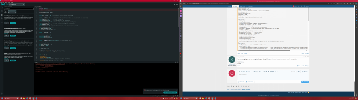

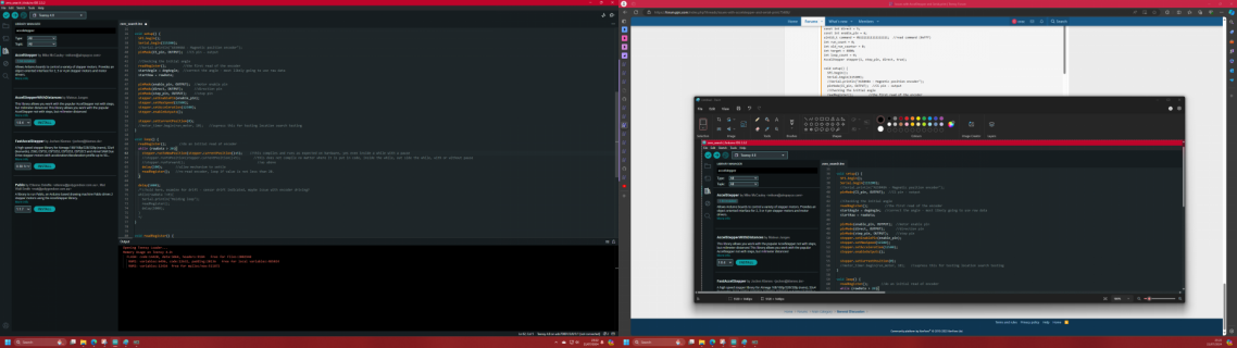

There's a major clue in the compiler report that you posted:
Multiple libraries were found for "AccelStepper.h"
Used: C:\Users\orac0\Documents\Arduino\libraries\AccelStepper
Not used: C:\Users\orac0\AppData\Local\Arduino15\packages\teensy\hardware\avr\1.59.0\libraries\AccelStepper
exit status 1
You need to remove/rename/disable the (wrong) AccelStepper library that is (mistakenly) being used !!

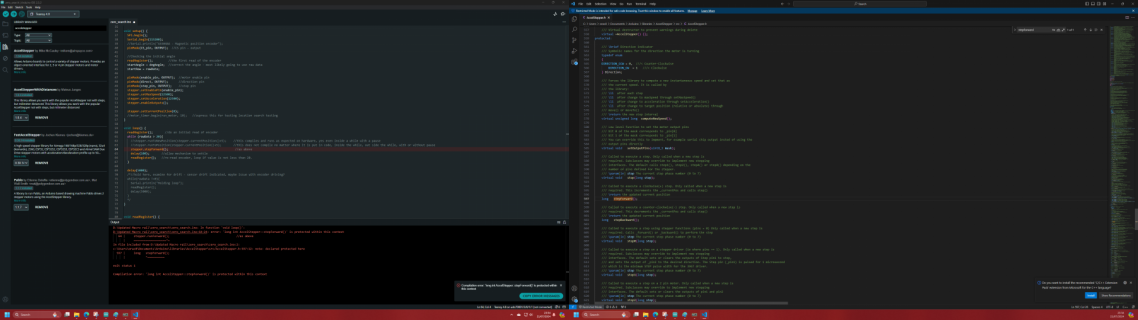

I have just tried uninstalling the library and reinstalling. The result has changed slightly.
Ouput:
D:\Updated Macro rail\zero_search\zero_search.ino: In function 'void loop()':
D:\Updated Macro rail\zero_search\zero_search.ino:64:13: error: 'class AccelStepper' has no member named 'runForward'; did you mean 'void (* AccelStepper::_forward)()'? (not accessible from this context)
   64 |     readRegister();
In file included from D:\Updated Macro rail\zero_search\zero_search.ino:2:
c:\Users\orac0\Documents\Arduino\libraries\AccelStepper\src/AccelStepper.h:710:12: note: declared private here

You are attempting to use the wrong AccelStepper library !! See post #12 above for what you need to do to fix your problem.
Mark J Culross
KD5RXT
I don't know what else I am supposed to do here. I have removed all traces of the library, made sure it was unistalled and reinstalled to the latest version.
This is the second time of doing this. After the first time the error message changed, this is what I posted above.
I tried installing all of the thing tagged with AccelStepper to no avail.
Seems that for some reason some comands have put into a protected class as i have issues with other comands in there too.
I am going to continue work with the code that works for the testing that I ma trying to run. I just know that i need to avoid some commands due to this issue

OK, sorry, I may not have been very clear in my earlier post(s). I'll attempt to give the instructions here in a way that is less ambiguous, and much more direct. Hopefully, that will make things clearer to understand.
As indicated in your post #7 above, the following library is present on your computer, and it is being used when attempting to compile your sketch:
- this is the wrong library (it is an Arduino generic version of the AccelStepper library, which is either installed by default when installing the Arduino IDE, or has been installed manually, using the Library Manager from the Arduino IDE)
- delete the entire folder for this library
As indicated in your post #7 above, the following library is *not* being used when attempting to compile your sketch:
C:Users\orac0\AppData\Local\Arduino15\packages\teensy\hardware\avr\1.59.0\libraries\AccelStepper
- this is actually the library that you want (it is a Teensy specific version of the AccelStepper library, which is installed automatically as part of TeensyDuino)
- re-install TD 1.59 to make sure that this library is still present
You can find the documentation for the Teensy version of the AccelStepper library <here>. If your sketch is attempting to make function calls to anything that is not listed on that reference page, then it will not work with the Teensy specific version of the library.
Hope that helps . . .
