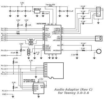

Here it is:
I have checked and double checked every single connection.
+ 3,3 V is connected to a pololu regulator (3,3 V)
GND is connected with GND of the regulator and the teensy
All other connections are as follows:
LRCLK pin 23
TX    pin 22
SCL   pin 19
SDA   pin 18
VOL   pin 15
SCLK  pin 14
RX    pin 13
MISO  pin 12
MCLK  pin 11
SDCS  pin 10
BCLK  pin 9
MOSI  pin 7
MEMCS pin 6

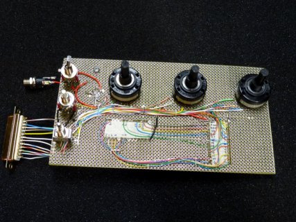

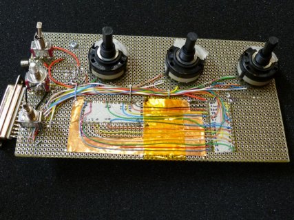

I had a similar problem with a T3.2 and an audio adaptor connected by wires that were about 3 inches long. It seems that there can be some clock skew and cross coupling in those wires, especially without a good low inductance ground between the two boards. This causes the clock and data to get out of sync, resulting in noise. Adding some copper foil under the wires and separating each one cured the random rude sounds. Kapton tape holds the wires to the copper foil, which is grounded in multiple places. Other sound anomalies were cured by replacing the cheap SD card with a true Class 10 card. The project has worked perfectly ever since. Pictures are before and after the added ground. BarryBox_4_x.jpgBarryBox_5_x.jpg

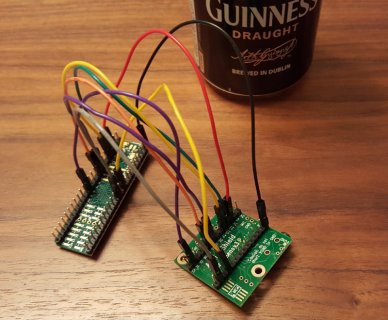

So this is the actual Setup:
Problem seems to be Pin 11 - MCLK.
Adding a 1K Resistor improved the stability a lot. (chaos when touching the resistor pins - same as before)
Im sorry I could not find the 10K Resistors. It stopped working with a 130K Resistor.
then I bridged Pin 11 from Teensy and Audio Board with a piece of a Guinness can....
(ok... in fact, i used one of the wires of a resistor.... i'm still not in office, so i have to improvise)
problems were gone then.
MCLK Fixed for me

But I can tell you, PJRC will soon make a revision to the audio shield to add a 100 ohm resistor to the MCLK signal.
