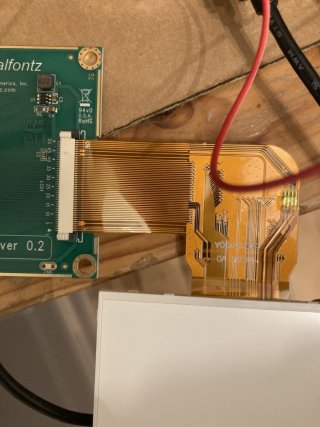

Just white display screen
JoeD.
Hello everyone,
“I’m upgrading my display screen to a CFAF320240F-035T TFT and switching from SPI to an 8-bit parallel interface. I’m having trouble getting it to work, so far the screen only shows solid white. I’ve been testing with simple sketches, and while the screen sometimes pulses slightly between shades of white, it never changes colors the way the sketch is programmed to. Does any have any tips or ideas why this isn't working? Here is a photo of how the screen is plugged into the carrier board and my pin layout into the Teensy 4.1. I have attached the code as well. Thanks for any help!
TFTTeensy 4.1 pinNotes
D0..D714,15,16,17,18,19,20,218-bit data bus (LSB→MSB)
WR (Write)22Active-low write strobe
RD (Read)23Usually kept high if you don’t read; still connect for compatibility
RS/DC2Data/Command (aka RS)
CS3TFT chip select
RESET4TFT reset
BL (Backlight)5 (PWM optional)Drive via N-MOSFET if high current; or direct if module has onboard driver

Sorry, I don't know much about this controller and the like. I see others mentioned code tags already
For example, I don't know how this device deals with CS pin. Does it like it on every byte, or does it want it around sort
of a logical transaction... Or it does not care...
void LCD_sendData8(uint8_t data)
digitalWriteFast(LCD_RS, HIGH); // Data mode
digitalWriteFast(LCD_CS, LOW); // Select LCD
writeData8(data);
digitalWriteFast(LCD_WR, LOW); // Write strobe
__asm__ __volatile__ ("nop\n\t nop\n\t nop\n\t nop\n\t"); // ~80ns delay
digitalWriteFast(LCD_WR, HIGH);
digitalWriteFast(LCD_CS, HIGH); // Deselect LCD
void LCD_sendData16(uint16_t data)
// Send as two 8-bit writes (MSB first)
LCD_sendData8(data >> 8);
LCD_sendData8(data & 0xFF);
In this for example if you are sending 16 bit values the CS is turned on and off... Also don't know if it needs any delays between
when CS is asserted and then the pulse...
Also unclear from your post on how the pins are setup: From their document assuming 8080 8 bit.
I am assuming that this is saying you are using pins DB10-17 for the data. Also what are your PS0-3 signals setup as?
Good luck
This may be a long shot, but a common issue causing with these LCD's causing white screens is the reset line. I see you are pulling it low in setup.
Looking at how other libs handle the reset is by cycling it with some delays.
    if (_rst < 255) {
        pinMode(_rst, OUTPUT);
        digitalWrite(_rst, HIGH);
        delay(5);
        digitalWrite(_rst, LOW);
        delay(20);
        delay(150);
Maybe this will help
