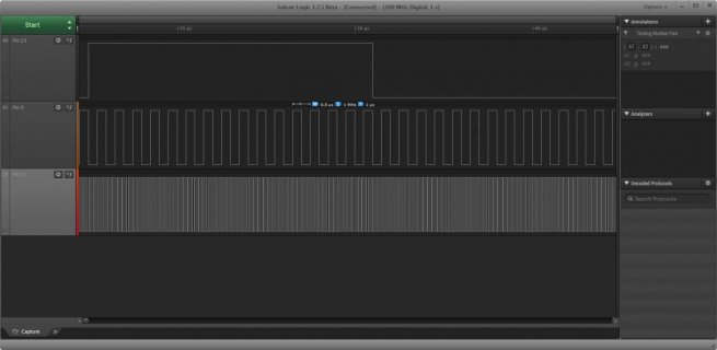

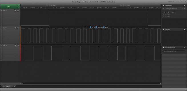

I2S compatibility
I try to get I2S running on K66, but have some problems
I took a program that runs as expected on T3.2 but it is not working on T3.5 (1.29b3 on 1.6.9)
// adapted from output_i2s.cpp
  #define MCLK_MULT 1
  #define MCLK_DIV  12
  #define TCR2_DIV  4  // bitclock = MCLK/(2*TCR2_DIV)
#if F_CPU >= 20000000
  #define MCLK_SRC  3  // the PLL
#else
  #define MCLK_SRC  0  // system clock
void config_i2s(void)
	SIM_SCGC6 |= SIM_SCGC6_I2S;
	// if either transmitter or receiver is enabled, do nothing
	if (I2S0_TCSR & I2S_TCSR_TE) return;
	// enable MCLK output
	I2S0_MCR = I2S_MCR_MICS(MCLK_SRC) | I2S_MCR_MOE;
	I2S0_MDR = I2S_MDR_FRACT((MCLK_MULT-1)) | I2S_MDR_DIVIDE((MCLK_DIV-1));
	// configure transmitter
	I2S0_TMR = 0;
	I2S0_TCR1 = I2S_TCR1_TFW(1);  // watermark at half fifo size
	I2S0_TCR2 = I2S_TCR2_SYNC(0) | I2S_TCR2_BCP | I2S_TCR2_MSEL(1)
		| I2S_TCR2_BCD | I2S_TCR2_DIV(TCR2_DIV-1);
// transmit on single channel
	I2S0_TCR3 = I2S_TCR3_TCE; // enable single transmit channel
	I2S0_TCR4 = I2S_TCR4_FRSZ(1) | I2S_TCR4_SYWD(15) | I2S_TCR4_MF
		| I2S_TCR4_FSE | I2S_TCR4_FSP | I2S_TCR4_FSD;
	I2S0_TCR5 = I2S_TCR5_WNW(15) | I2S_TCR5_W0W(15) | I2S_TCR5_FBT(15);
	// configure pin mux for 3 clock signals
	CORE_PIN23_CONFIG = PORT_PCR_MUX(6); // pin 23, PTC2, I2S0_TX_FS (LRCLK)
	CORE_PIN9_CONFIG  = PORT_PCR_MUX(6); // pin  9, PTC3, I2S0_TX_BCLK
	CORE_PIN11_CONFIG = PORT_PCR_MUX(6); // pin 11, PTC6, I2S0_MCLK
  I2S0_TCSR |= I2S_TCSR_TE | I2S_TCSR_BCE; // TX clock enable,
//  while(!Serial);
  config_i2s();

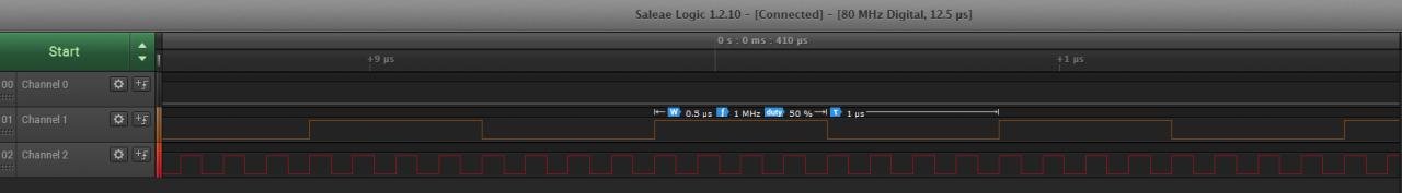

watching the MCLK, BCLK, and FS lines, I get for T3.2 what I expect
that is MCLK = 8 MHz, BCLK= 1 MHz, LR = 31.25 kHz
but for T3.5 I get
or
MCLK (pin 11) = 4.x MHz, BCLK = 12.5 MHz, LR = 374 kHz
for T3.2 dividers are MCLK = F_CPU/12, BCLK = MCLK/8, LR = BCLK/32
for T3.5 it seems only that LR = about BCLK/32, but MCLK and BCLK are not correct, in particular BCLK > MCLK (Yes, I double checked pins)
anyone already found solution?

That was the basis for my code, which is working in T3.2
Correcting myself
there is a small difference between the actual version and the one I was using, that makes the difference (highlighted)
  [B]while (I2S0_MCR & I2S_MCR_DUF) ;[/B]
Seems K66 is executing faster than K20 so a wait is required.

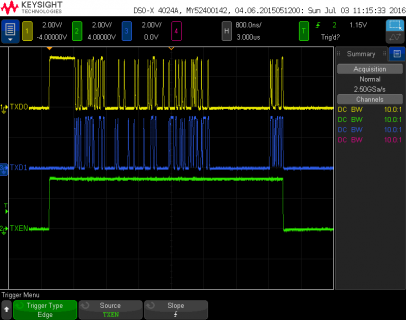

More great news, I managed to transmit an ARP reply! My Linux machine now knows the mac address and I can receive ping packets without using broadcasting or promiscuous mode. Just committed the transmit code to github.
So are you planning on rolling your own TCP/IP stack, or lwIP, or ?
At this moment, my focus is just testing the hardware. I want to be absolutely sure ethernet works, so we don't end up in a situation like Arduino Due, where the chip has a 100 Mbit/sec ethernet capability that nobody can use because the board doesn't make it available. Realistically, I'm going to get ping reply working and test MDIO communication, and build up the other 2 boards (I will personally solder these 2 since Erin doesn't work until Tuesday) and order materials for about a dozen more, and then pretty much stop working on the ethernet stuff for quite a while.
LwIP certainly does seem like the path of least resistance. I'm willing to consider others, but as I explained earlier, I don't feel right about shipping GPL source to people I believe will end up violating the GPL terms. Seems unlikely I'll write a TCP/IP stack from scratch. But hacking and tweaking LwIP (perhaps more than most people do) seems likely.
.... there's all the housekeeping: memory mgt, interrupt mgt, timer mgt ... the fun begins.
One thing I have considered is memory allocation from a pool of 512 byte blocks, to be used by SDIO, ethernet and USBHS. SDIO and USBHS (sans isync) need 512 byte buffers. The ethernet mac does have the ability to automatically segment received packets into multiple buffers, and combine multiple buffers when transmitting. A max size ethernet frame fits nicely in 3 buffers. In fact, that's how I've got the code configured now. Well, except it only deals with small packets and would need more complexity to handle the 2 and 3 buffer cases. LwIP looks like it wants single buffers...
But other than thinking ahead and tentatively planning on a fixed 512 byte buffer size for all 3 high speed peripherals, I'm really trying to resist the urge to do more on the ethernet. My purpose is to verify the hardware really works, that I didn't forget a crucial pin or there isn't some silicon bug or other unforeseen issue which must be addressed in hardware before we start manufacturing these boards. Unless a serious problem comes up, I probably won't touch ethernet again until after the boards are shipping and all the major distributors have them in stock.
Wow, your receiving sketch looks elegant and simpler than I had hoped. So are you planning on rolling your own TCP/IP stack, or lwIP, or ? I recall you hoped to avoid any RTOS. Besides TCP/IP/UDP, there's all the housekeeping: memory mgt, interrupt mgt, timer mgt ... the fun begins.
I need to start learning more advanced stuff :(
Here's a screenshot of the very first packet transmitted (well, other than the flow control ones the hardware sends automatically if you turn on flow control).
I believe the part at the beginning where TXD0 is high and TXD1 is low is probably the 7 byte ethernet preamble, which the PHYs use for clock recovery and sync. This APR reply is 42 bytes, which has 12 bytes for ethernet frame header and 28 bytes for the ARP message. You can see in the waveforms where the mac automatically adds zero padding to extend to the minimum ethernet frame size, and then add the 32 bit CRC check on the end.
