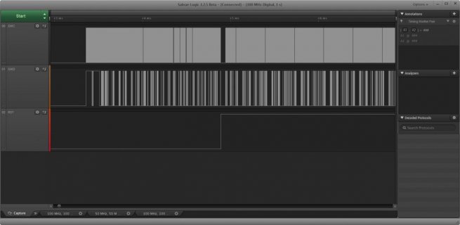

but without warning: no response: device not reccognised code 43(win10), no changes in HW setup, T3.5 connected via hub to PC.
OK, I tried all what I know (plug in with Prob button pressed, reboot PC, removed hub, uninstall all com and hid entries, multiple times
but device shows up in dev manager but as unknown device once prog button is pressed (and no comport, when powered up, USB plugged into PC)
watched rst pin on analyser
plug into usb (no com port shows up)
: rst pin sends every 67 ms a positive pulse
pressing prg button (pc recognized unknown USB devive)
: SWC, SWD, RST lines show behavior as shown in figure
It seems the bootchip and the K66 are talking
Unfortunately this goes forever
Anything I can try?

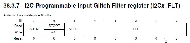

Two things, first is just sort of an FYI regarding I2C - it answers a question I had on the LC device a long time back, but I couldn't figure it out. I think the K66 documentation has the answer.
In working on the I2C STOP interrupt for LC I ran across this weird behavior on the I2Cx_FLT register. This is the description from the KL26 doc:
For some reason bit4 was toggling and I couldn't figure it out, I even wrote a comment in the i2c_t3 code for it:
            // There is some weird undocumented stuff going on with the I2C_FLT register on LC.
            // If you read it back, bit4 is toggling, but it is supposed to be part of FLT setting.
            // Writing just the STOPF bit causes things to get stuck, but writing back the read value
            // seems to work

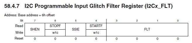

Well now I'm looking at K66, it has this description in the doc:
Notice bit4 is STARTF, and it is write-1-clear (which is why writing back the read value worked).
I think this is a documentation error on KL26, and it is probably the same as K66. If so, it's actually lucky this bit didn't cause more problems back when LC came out. I think it is because the enable for it is the same as the STOPF enable (both use SSIE).

If Paul, after looking to the figures I showed earlier, feels that both devices are active, then I may get me a swd programmer and try programming K66 directly.
Any suggestion on SWD programming?
If you have an Raspberry PI, you might try installing Arduino for ARM... Probably won't behave much different, but you never know...
Also I am pretty sure you are already doing so, but just in case, you removed everything plugged into the board, including all any IO pins, SDCard, ... Also you have tried different USB cables... I had a point maybe a week ago, where it did not want to program, but it was cleared, when I rebooted and also like some others, I think I may have in between programmed a T3.2...
I have in fact an RPI (B), I may try.
otherwise: all wires disconnected, with/without led-board, reprogrammed on same port T3.2.
I note that RST is going high, SWC/SWD is continuously active (but we do not know what exactly the bootloader chip does, so I do not know if this continuous activity is good or bad)
Maybe I take this as hint (from oute space) to continue with T3.2.
