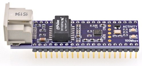

ethernet shield testing on K66/K64 sticky post (i'll continue to update this post with new data ...)
running 1.6.9 with 1.29beta4 on ubuntu (32-bit), lwIP 1.4.0
K66 beta PROTO6 board (and K64 beta, 8/31/16)
ether shield with PHY LAN8720A, RJ45, two LEDs, 3.3v/gnd, and 12 K66 pins (8 required): 3,4,24-28,39, (16-19)
