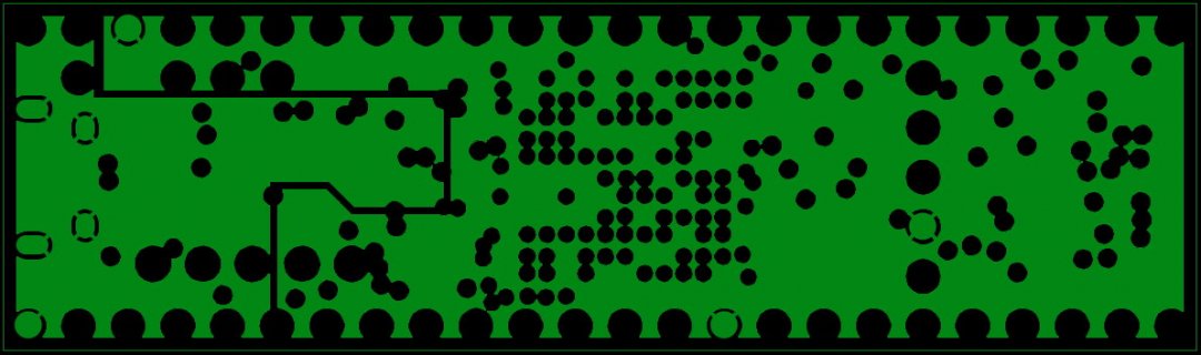

Including for example my Excel document, which here is my current one, which has the updated tabs.
Also earlier in the thread is my diptrace versions. In case anyone is interested I also uploaded newer version with my experiment for cutouts to maybe solder directly...
Also not sure if anyone is interested, but I also have my 3d step file, I created to view in 3d in diptrace. Current version is shown in my breakout board thread:
attachment.php
  • Teensy 3.6 breakout Layout.pdf

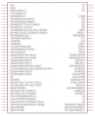

Latest updates for the eagle symbol. Think I have learned to decipher the datasheet.
I will post it tomorrow after I have had time to double check/cleanup and get comments.

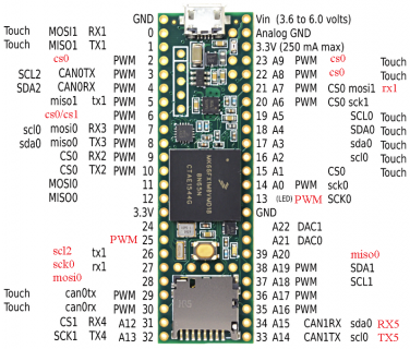

Made a few more changes and grabbed the T36 top card and added some markings(RX5/TX5).
Has anyone started the T36 backside card? If not I may do a lazy mans paint version just to get it started.
edit.. edit2.. damn autocorrect
Looks great, may have to update my Diptrace version to have some more information and maybe the order of things. One thing I wonder about as I do that is what to do with all of the GND and 3.3v pins. I typically add them as their own entry on the Schematic Component and Pattern and I either add some or all of them to the same signal like GND. The problem is each one I add, I then typically have to run etch between them as the system does not know they are connected. Not sure if I can tell Diptrace they are connected, and sometimes probably don't want them to be assumed as for example would not want all of the servos to run their GND through the chip...
For eagle I have to name each pin differently so I do something like GND0, GND1, GND2 and so on, then when I combine the Symbol and Footprint I just select all the pins for the 1 GND connection I put on the symbol. For Kicad I have to have 1 Connection for Each pin, which can be annoying when you have a lot of grounds lol.

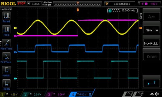

First run today with Teensy 3.6 beta. Nice to see Blinky again after changing the Arduino/Teensyduino to 1.6.11 and 1.30 beta3.
My code for the "Precision Frequency Standard" ran first time with no changes at all. Interesting that this config is using the Epson 16 MHz module - my previous test on T3.1 had an NDK 16 MHz module, so the digital capacitors are working great and still dithering between OSC_CR = "02h" and "0Ch" to hit the sweet spot on frequency. The evidence is here in the scope display of the phase locked 60 KHz... (now using a 3.3v supply obviously on the CD4046 to comply with signal input demands...)

I extracted this from a sorted version of the K66/T3.6 pinout. Ports C and D are the best bets for 8 contiguous pins:
Port pin   Teensy pin
 PTC0       15
 PTC1       22
 PTC2       23
 PTC3        9
 PTC4       10
 PTC5       13
 PTC6       11
 PTC7       12
 PTD0        2
 PTD1       14
 PTD2        7
 PTD3        8
 PTD4        6
 PTD5       20
 PTD6       21
 PTD7        5
Pete

A simple T3.6 query... is there any physical difference/advantage/disadvantage to drawing current (up to 250 mA) from the 3.3v pin located between pins 12 and 24 in comparison to doing this from the 3.3v pin between pin 23 and AnalogGND?
I'm wondering about track thickness/length/routing and potential local heating effects (especially near the 16 MHz crystal module) ??
Is one of these pins much closer to the regulator (and thereby a preferable power source) ?
All of them are connected by a power plane on layer 5. But that plane layer is split, where the portion underneath the regulator is GND, which is done to give the thermal vias 2 planes (all of layer 2 is the plane for ground) to help dissipate the heat.
