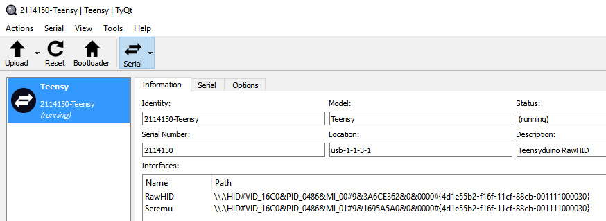

I just got home and found a BETA Teensy 3.5 in my mailbox - delivered 12 minutes earlier - I'm excited to see what Frank is up to.
Powered and BLINKING - and looks like this to TYQT on WINDOWS 10::

Manitou - Of course it did ... errr ... good to hear :). I got my headers on and didn't get back to it tonight. I had a bit of diagnosing TYQT that doesn't know the magic name for handshake with the T_3.5 so I hopefully got details Koromix needs to clear that up and then I can enjoy using it rather than having it confuse the T_3.5 for a T_3.6.

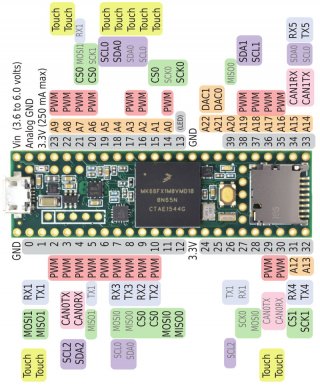

Here a draft of the latest pinout card. Hopefully I got all the pins right this time?
I should explain a sort of double standard regarding display of alternate pin functions. For communication signals, alternates are shown. But for PWM and SPI chip selects, alternate locations are not shown on the pinout card. For example, pin 25 is PTA5 & FTM0_CH2, but it's not shown as PWM because we use pin 9 for that FTM0_CH2 signal.
Hi Paul,
I will take a look, Personally I wish the card could show all of the alternate SPI CS pins, or at least have some easy to find location that does. Unless you are someone like me, who goes and looks at the code, about the only place that I remember that sort-of documents it for T3.2 is the ILI9341 display page that says, you can use these pins but not these... But I also understand there is only so much room and a potential for too much information.
These days I go to my Excel document or Michael's documents.
This is probably more along the lines of a web dev sort of thing but it would be amazing to have an interactive pin out diagram for the teensys. One that could display the whole functionality for a pin or you do something like "highlight SPI1" and all the pins related to SPI1 are highlighted and everything else dulls out. That would be super sweet for visualising the pinout.
The original Teensy 3.0 card did this. The duplicated pins became terribly confusing when people tried to use multiple libraries like Ethernet and ILI9431_t3 which use the hardware CS feature.
T... an interactive pin out diagram for the teensys. One that could display the whole functionality for a pin or you do something like "highlight SPI1" and all the pins related to SPI1 are highlighted and everything else dulls out. That would be super sweet for visualising the pinout.
That would be mighty sweet. :)
Maybe it could also have a couple documentation panels that auto-update with details for the selected pin and info about the peripheral with links to examples or libraries?
Maybe it could even allow you to somehow choose how you'll use the pin and adjust what it does with the others. Maybe you somehow say you're choosing to use pin 5 at TX1. Then it could disable or hide the other TX1 options, maybe change how other pins display as appropriate?
Anyone particularly good with Javascript and toolkits like jQuery & D3 want to take this on?
That's exactly the kind of thing i was thinking. Probably really useful for folks new to teensy to see that when you use certain functionalities it can have knock-on effects.
I totally hear you. For me, what I do is not just mark it as CS but also which channel: So for example:
Pin 2 could be marked as CS-0 So is pin 10 and pin 26 - And you have to know that if your program uses Hardware SPI CS pins, it can only use one of the ones that are on the same channel...
As mentioned would be great to have interactive pin diagram and of course we can put lots more details like this up in a WIKI later on.
