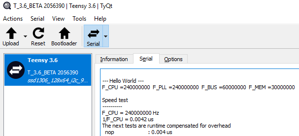

Works 'well enough' ... For TYQT to get the serial # it has to pass through bootloader mode - which is what is need to program. TYQT does talk serial - and it should be there but without a change in startup I was wondering how that could be.
This at 240 MHz on a T_3.6 with fresh IDE 1.6.12 and TD_1.31b1 with no hacks. I saw it working well enough after the bootloader update.
Given my time with EEPROM and HSRUN OFF/ON I just did this and it works - HighSpeed T_3.6 serial number known at USB connect- interrupts are already disabled so it should be safe:
<EDIT> : Pull request below
@KurtE - please test this - it has worked for HOURS doing EEPROM I/O much more extensive - I think this is a good answer.
Note: My latest testing did plenty of USB SPEW before and after repeated continuous EEPROM writes over days and USB was never broken.
