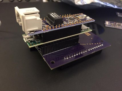

ok, pic attached. does this look right to you guys? I just want to make sure before applying power.
The lowest board is an adapter I did that directly accepts teensy 3.2 to interface to arduino form factor. Been using it for a while now.

Yes looks good. The Ether board edges should line up with the T3.6 Board edges and the RJ45 socket be above the USB socket.
However you are missing a few pins at the SD end that are needed for the Ether board. Specifically pin 28,27 and 3v3/GND.
You may also want to bring up the Prog pin as the Push button is now quite inaccessible.

Yes, you need 28,27, but i think 3v3/grnd is connected (between 12/24 and dac1/13)
and just setting the PCB on the pins is likely to fail -- need to solder
Applying power, the PCB LEDs won't light unless you have a live ether cable into the RJ45, then you should have two
green LEDs on

As long as the side pins are there like the picture you are good - that is what the Beta board from PJRC was like - and that line of cross pins on shield lines up with the line on the T_3.6 at the SD when mounted
I would not rely entirely on the pin between 12/24 as your only source of 3v3 as that is only connecting the other 3v3 pin via the through hole plating and a very small trace. There are a few other parts of the board that are feeding off the middle 3v, specifically the main transceiver IC. The below PCB routing shows this.
wow, that is some skinny traces on the supply lines, not something I would build knowingly.
Has anyone done power consumption measurements on the combo teensy 3.6 and ethernet? I'd like to see if I can move to a regulator smaller than that giant TO-220.
