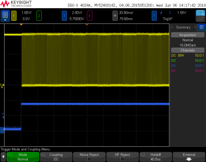

I ran it just now on a Teensy 3.6. I connected a 10K resistor from 14/A0 to GND.
First, the threshold is too low. It transmits a continuous stream of data.
With the threshold increased to 50, here is what I see on pin 1 (Serial1 TX) when I touch a wire between 14/A0 and 3.3V.
The latency from the moment the voltage at A0/14 goes high until the first start bit of the MIDI message looks like about 400 us (not quite a 1 division). Looks very fast to me on Teensy 3.6. Even if it becomes 16X slower when using all 16 inputs, the speed is very good.
However, there's another possible problem. This code (did you write it?) appears to continue sending messages repeated if the signal stays above the threashold. Here's what I see on the scope if I zoom out to view 0.2 seconds.

So what are you saying about values other than 1023... it sounds like you have hardware problems.
i made change in the code when I was able to get others values but can t remember what did I changed... I m lost with these piezo :)
maybe my piezo are not the good ones?
