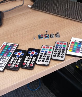

Any one has any luck with this library and a teensy 3.1.
I have tried all sorts of IR remotes and a few sensors I bought of ebay but none of them seem to work. They all receive data but the library can never understand the encoding and just returns FFFFFF all the time.
Is there a special type of sensor I need to use?

Yeah i started off at that page using the source from the zip file same problem. Im 99% sure that zip is just an older version of this library. Maybe I should buy the exact sensor they are using in that example. Although I find it hard to beleave these ebay ones are all bad. When I pres buttons you can see the LED flickering away so its definitely picking up the signal.
What sensors have other people being using?

man I just can not get any life out of any ir lib or sensor or remote lol. tried 3 different libs now about 6 different remotes and about 4 different sensors
current setup using
remotes: (from above picture)
sensors: tsop4438/tsop38238 (as mention as known working ir sensors)
ir sensor out connected to pin 32 (directly)
power to +5 on teensy 3.1
ground to gnd on teensy
and all I see is this (picture)
I am at a complete loss what I am going wrong literally nothing seems to work for what should be such a simple project. Are there any kits out there that have the ir sensor / remote / source code / known to be working on teensy. Because I have to be missing some thing or making some big mistake some where to just get the same result no matter what I do.

@paul
If you apply the fix I found (in my second post) the latest version of that irRemote will compile.
I would really like this lib to work with these cheap ebay rgl led remotes as they are ideal for projects. (Im pretty sure it does work but I just cant seem to get it working lol)
Example of remotes:
http://www.ebay.co.uk/itm/Hot-Sale-...-Light-Lamp-/191250030421?hash=item2c8763df55
http://www.ebay.co.uk/itm/3Key-10Ke...Strips-/371382955618?var=&hash=item5678262e62
http://www.ebay.co.uk/itm/16-Color-...hiping-/271944112262?var=&hash=item3f5121d886
http://www.ebay.co.uk/itm/Mini-24Ke...ED-Strip-VM-/221765864281?hash=item33a2468b59
http://www.ebay.co.uk/itm/IR-Infrar...ino-AVR-PIC-/371343222490?hash=item5675c7e6da
http://www.ebay.co.uk/itm/Infrared-...For-Arduino-/221791990037?hash=item33a3d53115
be great to be able to just drop these into any project :)
from my understanding they all use the NEC protocol but the data im receiving when using a teensy 3.1 (120mhz optimized) with the latest irRemote arduino library it cant decode any of the above remotes :(. Im not sure if it does not working with these remotes? or they used a tweaked version of the NEC? or my teensy is setup wrong?
But looking at the NEC protocol it says there should be a 9ms pulse followed by a 4.5ms pulse I am not even seeing this in the debug data.
Ok slowly figuring this out.
One thing to note is the speed you over clock the teensy 3.1 seems to effect it. Like 120mhz NOTHING works all the timings are wrong. But on 96mhz I can get my Technika (tv) remote to work 100% using the RC5 protocol.
But all these rgb led remotes use NEC protocol. But they are random pressing same button will work say 10% of the time. It knows it NEC protocol and all the timings look correct (9ms followed by 4.5ms and 0s and 1s timings are cool) yet only works 10% of the time other 90% just shows random data. So timing must be out some where although it looks good to me?
As I write this NEC seems to work 90% of the time now
Encoding : NEC
Code : F730CF (32 bits)

Hardware: Teensy 3.1 / 3.0
SW: Arduino 1.65 / Teensyduino 1.24
Library: From Teensyduino (C:\Program Files\Arduino\hardware\teensy\avr\libraries\IRremote in my case)
Sensors:
* TSOP38238 (through hole)
* TSOP57238TT1 (surface mount)
Remotes:
* SparkFun (https://www.sparkfun.com/products/13235)
* Apple (both white plastic and aluminum)
* Generic (http://www.amazon.com/gp/product/B0016RNSHS?psc=1&redirect=true&ref_=oh_aui_detailpage_o01_s00)
* Samsung TV
