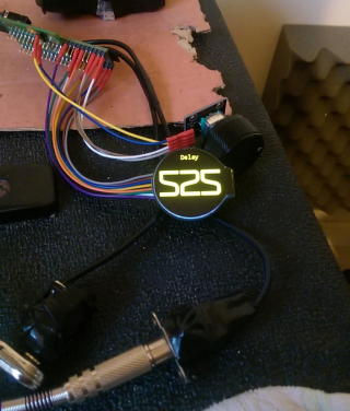

For one of my pedals, I'm using this round 240x240 GC9A01A SPI display as pictured here:
Yes, the GC9A01A is a very nice display. That's about 1.28" diameter, so pretty similar to the 1.3" 128x64 in terms of size, but of course you do get 16-bit colour plus some extra real estate for the bank names (though probably not enough to be readable when standing).
