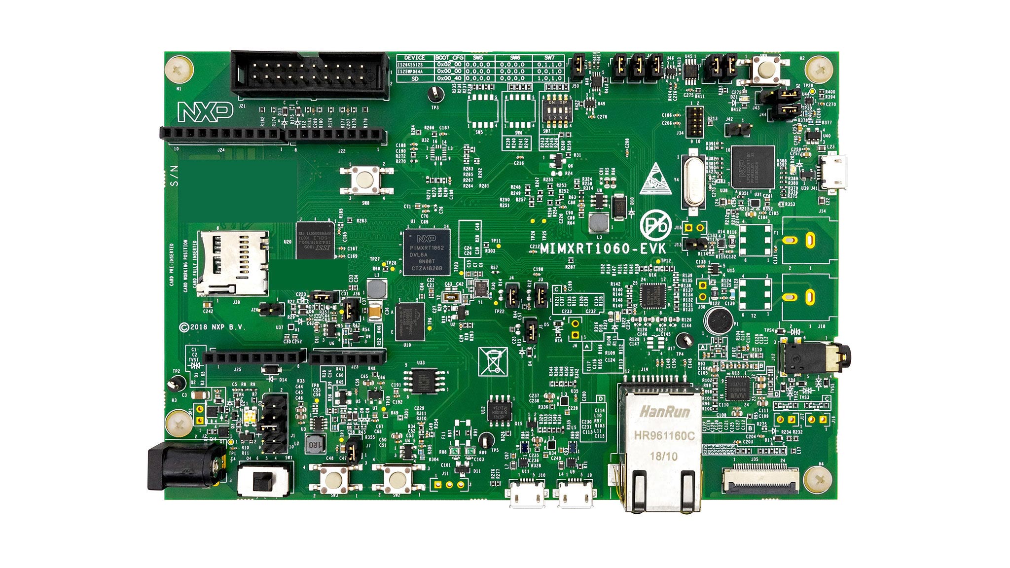

If you're working with the IMXRT1062 at this level, you might want to consider purchasing an NXP development kit and setting up the MCUXpresso environment for checking it out. It's not a Teensy with Teensyduino of course. But it's a powerful way to become familiar with the chip and its features, which seems to be what you're looking for before applying in the Teensy environment.
I used MCUXpresso on a project 5 years ago, though for a different processor and dev kit (LPC54628). More recently, I worked with a similar dev kit and environment for STM32Cube processors. MCUXpresso and STM32CubeIDE are both based on an Eclipse model, and MCUXpresso also now includes a version for Visual Studio Code. There's definitely a learning curve for working with these dev kits and environments, but it seems you're already on that path.
Working in a tool such as MCUXpresso provides a powerful development environment, with the ability to set breakpoints, look at registers, and all the other features one expects; and lots of example code to demonstrate various features of the chip. Though I'm not familiar with the configuration options for the chip available in MCUXpresso, I made extensive use of the tools in STM32IDE which allow you to configure all sorts of processor options (port assignments, clock routing, etc.) and then generate the base startup code to configure the chip. A similar configuration tool is provided in the MCUXpresso environment.
I know this doesn't relate specifically to Teensy, but it might provide a much better understanding of the underlying features and usage of the IMXRT1062 you're examining. You'll need to spend a bit of $ (the dev kit is around $120, but includes a touchscreen and all sorts of IO). Not sure how far you want to go with this, or if my suggestions are helpful, but I hope it's of some use.
MCUXpresso IDE:
MCUXpresso Config Tools: Pins, Clocks and Peripherals:
i.MX RT1060 Evaluation Kit:
Digikey part #:
568-MIMXRT1060-EVKB-ND ($121.17)
Hi @Neurofrantic - this is very sensible advice, and $120 USD is a small amount to pay for this. I have worked with the Eclipse IDE and the STM32 framework over the last few years, and I liked the insight the 'MX' tool gave to programming peripherals, where the necessary setting to make some stuff work was pretty much instant and plonked directly into the code. (ADC to DMA, for example! :) ) Most examples worked out of the box. The Eclipse IDE was a little cumbersome at first. However, separating modules like a proper IDE was so nice. Arduino IDE can do that now, which is great, of course.
The support from the Teensy programming environment that people here have written is invaluable, but you have to consult the manual quite extensively for any 'whys and wherefores' at the lower levels (trying to infer the logic of what they have written). I don't want to be stuck at that 'introductory level' for too long. Even though much work has been done here, when I understand the background better, using the pre-canned code base will be much more comfortable (less guesswork). Paul S is a "gun", and what he has done here is legion, given the immensity of the IMXRT1062 and the need (vision) to democratise the NXP chip(s). The NXP processor for Teensy 4.x is in a league of its own. I came for the 600 megahertz clock speed and stayed for the extensive sophistication of this machine :D My next step will be to move back to the Eclipse IDE with the MCUXpresso tools. Great suggestion. I had not realised that an analogue like this existed.

Update - I just bought the MCUXpresso and IMRT1060 evaluation board from NXP. You were right, this is the way to goodness. They want to know what you're using it for and when you're going to go to production - me? Production? I had to lie, of course. However I do want to make a CNC controller using the Teensy board as the backbone, but that's a fair way away. I have made such controllers since the days of the Z80 and the 8051 (back in the 9'0's) with a detour into PIC32, STM32, and now Teensy 4.x. It's not my day job. I just like the elegance of these things and to find out what makes them tick.
You move fast, Steve_AU! Pleased to hear that you will be checking out the evaluation board. I look forward to hearing more about your experience with the setup, and hope you find it helpful. I agree that these devices in the current 600MHz+ range are quite impressive. Like you, I have a very long history of working with chips of all sorts. I've done contract work on embedded systems for many years in support of my efforts in developing SW/HW for music and arts related projects for myself and other artists. But these newer generation MCUs just blow me away with their design and capabilities. A 600MHz Teensy 4.1 is really capable of doing things one needed a full-scale desktop or laptop 20-25 years ago (last project on the STM32 series was doing 60Hz screen updates, running on a 200MHz clock, with plenty of BW to handle the actual work of the system it was running on, which was an industrial meter and controller).
I've never been a big fan of open-source, finding coding often of poor quality and absent even basic documentation or comments. But I've now been using Teensy for several years, and though I still find it frustrating, as do you, when attempting to understand or analyze code in the libraries, or from other sources, I've come to have great respect for the efforts so many have put in and made freely available to others. In the end, the fact that they actually work (in most cases) so that you can focus instead on the task at hand, is the overriding consideration. So I have to give my heartfelt thanks and respect to all those whose contributions over the years in support of the community have been so essential and important, and especially Paul S., whose work has enabled so many of us to succeed in our own individual efforts.
Still, in the end, one sometimes requires something a bit more, and I hope you'll find what you need in working with the dev kit.
