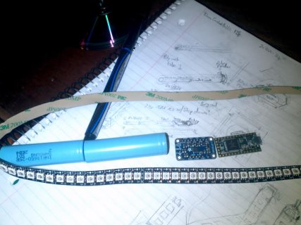

LED Poi w/ 9DOF Questions/Guidance

for lipo cylinder cells look on amazon: 18650 and 14500 - both 3.7v one larger (2000+mAh), one is "AA" sized package (800+mAh). Many show false specs on mAh and may be counterfeit. BatteryJunction.com may be a more reputable source I'd bought from. The picture I see looks to be the 18650 cell.
You can get spring holders or through hole solder clips for either - I saw them on Sparkfun.
I have bought from onehorse and his stuff looks good and what I've tried went well with his 9DOF, but I've spent too little time using it so far. Doing two cells in parallel worries me in that both won't charge perfectly, that might be okay in short term if you can cycle them out for proper full charging on some regular basis. Using in series would prevent effective 'onboard' charging at all - and you couldn't use the onehorse unit. The Teensy needs only 3.3v, but if you step up to 5v that is another factor.

I've not programmed APA102's (Adafruit Dotstars) but I have programmed WS2812's (Adafruit neopixels), where voltage conversion is a problem.
Now, WS2812's can actually run at 3.5-5.5v, and there are several different ways to power the LEDs:
  • Using 3.7v li-pos/18650 batteries connected to VIN and to the LEDs, you don't need level conversions, as the 3.3v that the Teensy uses is close enough to the 3.7-4.2v that the battery produces. You will might problems if you power the LEDs with USB (for example when programming the Teensy), since some LEDs will not work when the power is 5v and the data signal is 3.3v. You can cut the trace between VIN and VUSB, which would mean you would have to have the battery on when programming the Teensy (or just ignore random errors when programming, and unplug the cable to actually try things out). However, APA102's might be stricter than WS2812's and you might not be able to light them properly with 3.7v.
  • If your entire LED string can be powered from the Teensy 3.3v bus, you can power the Teensy however you want and not do level conversion. However, if you do it this way, you are running the LEDs under-spec (so far, all of the WS2812's that I have will work with 3.3v). You also have to be careful to limit the power to the LEDs. I did some back of the envelope calculations, and for 32 LEDs, if I kept the max power level of any LED to under 30 per LED (sum of red, green, and blue power levels), the whole LED string would draw about 75mA which works well with the Teensy. However, you want double the number of LEDs, so I'm not sure is having the max power would work for your application.
  • Using the Teensy-LC, you have one pin (A3/17) that has a level converted output that can be used, and you can use VIN for the output. However for APA102's that isn't feasible, since you need two wires converted. If you were to switch to WS2812's, note that the speed that you can drive the LEDs is fixed and it isn't quite fast enough for POV type builds (APA102's are faster, and can be used for POV).
  • Add explicit voltage level conversion. There are other current discussions about level conversion at this site, so you might want to look it up (the typical i2c converter that you can find lots of places has problems with high speed lights). In general for LED projects the 74LVC245 seems to be the best. but the through hole version is 20 (2x10) pin, if size is a consideration. For converting up to 4 lines, I like the level converter from pololu (2x5 through hole): https://www.pololu.com/product/2595
This seems to be a standard resistor + FET network which is not really appropriate for fast signals, especially I2C. Here is a better solution for I2C, which needs the bidirectionality. If you have unidirectional signals, the 74LVC245 is probably best.
I would recommend separate LED and Teensy power supplies; but both will be connected by a control data line which might need logic level (3V3 to/from 5V) conversion IIUC.

You can power a Teensy by
  • 5v via USB. If you have not cut the solder jumper from VIN to VUSB you can draw about 500mA (3.0/3.1) or 350mA (LC) via the VIN pin if you are powering the Teensy via USB;
  • 3.7-5.5v via the VIN pin. If you have cut the jumper from VIN to VUSB, you must provide power on VIN when programming the Teensy;
  • Regulated 3.3v power to one of the two 3.3v pins.
No mater how you power the Teensy, the digital data pins will emit 3.3v when you do a digitalWrite function call. Some pins cannot be used for digitalWrite, and can only be used for analogRead. I don't recall off hand how many micro amps you can pull off of a data pin on the 3.1. On the LC, it is 5mA for most pins, and 20mA for 4 pins.
On the 3.1 and LC, the DAC pin can emit voltage between 0 and 3.3v using analogWrite (it may be possible to reduce the max. voltage of the DAC below 3.3v). You would not typically use the DAC pin for WS2812 or APA102 LEDs.
On the Teensy 3.0 you can draw about 155mA of total power from the 3.3v pin. On the Teensy 3.1 this is about 185mA, and on the LC it is about 120mA. While those are the limits in the datasheet, in the past Paul has recommended that you never draw more than 100mA for any of the Teensys. Hence when I'm doing WS2812's for costumes, I limit the total power to about 75mA, so that I can power it via the 3.3v pin.
For LED strings, if you are powering the LEDs via a 5v source, the problem is the LED microprocessor might not notice the transition from 0-3.3v as being high. Some will work with 3.3v, some will not. As I mentioned, I have a variety of neopixels from Adafruit, and the older ones have no problems with 3.3v data signals using 5v sources. The newer LEDS tend to be pickier and I have to do level shifting if I'm powering the neopixels via 5v USB power. If I power the Teensy via a 3.7v lipo battery, all neopixels will work correctly (and when I hook up the 5v USB to program the neopixel, some things will not work, and I need to unplug the Teensy from USB to see if things are working correctly). So, I would plan on having to do level shifting. As I mentioned for neopixel work (but not APA102), the LC is interesting because it has a free level shifter. But for APA102 work, you need to think of level shifting, and the 74HCT245 is the preferred level shifter.

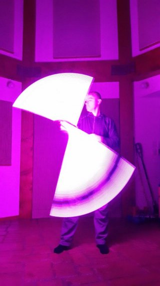

I'm working on something similar: Teensy 3.1, LSM9DS0 motion sensor, 12 14500 Li-Ion cells, 90 Watts of UBECs powering 800 LEDs as four parallel strips of 200 APA102 LEDs.
Progress as of this week:
Given previous experience with NeoPixel strips, I like to make absolutely bloody certain that the power demand of the strips can't brown out the Teensy. Hence different DC-DC converters for the Teensy and the strips.
For the motion control, I'm just detecting spins, rolls, and holds in particular positions. Those signals then trigger particular modes. I'd like to get pattern generation linked to spin speed, but that's a stretch goal for now. Current issue is the Adafruit_Dotstar library being particularly slow to update the LEDs (like 5.7 ms for 200), next step is to update my code to use FastLED.
