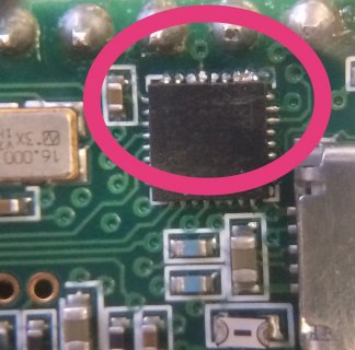

As the title states, I physically damaged my Teensy 3.1 while trying to remove solder paste . . . with the end of a paper clip . . .

- I successfully soldered the Teensy 3.1 to the OctoWS2811 Adaptor and got the BasicTest_UserMod sketch running with an Adafruit NeoPixel 8X8.
- I then started worrying about the long term effect of all the excess solder paste, so I used a chem-wipe to try and remove the residue.
- When the chem-wipe failed, I switched to a brown paper towel wrapped around a small slotted screw driver--to this point the assembly continued to work and I was able to test several other sketches . . .
- But then I went the extra distance and started really removing solder paste with the end of a paper clip . . .
I started to troubleshoot the failure to upload a sketch:
- I checked that the board was getting the correct voltage
- I checked that the program pin was being pulled to 0V when the button was pressed
- I searched high and low for any article or posting that referenced the issue
- I tried both Mac and Windows machines
- Then I decided to actually look at the board . . .
My scratching did remove solder paste, but it also damaged at least a few of the 8 pins on that side of the chip.
I now have a soft brush and some rubbing alcohol to try with the next board.
