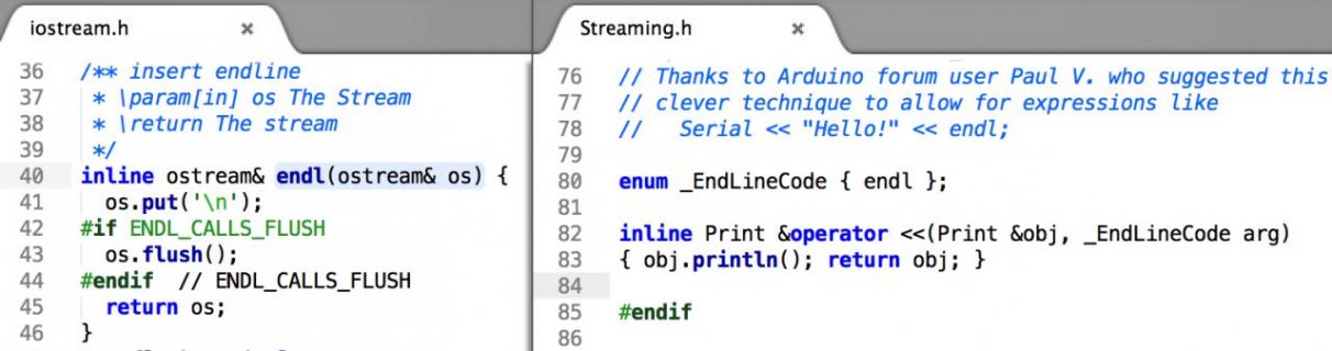

library conflict with redefining << operator?
Have a little conflict with a library when i compile
In file included from /Arduino.app/Contents/Resources/Java/libraries/SdFat/SdStream.h:27:0,
                 from /Arduino.app/Contents/Resources/Java/libraries/SdFat/SdFat.h:39,
                 from cylinderTest3.ino:3:
/Arduino.app/Contents/Resources/Java/libraries/SdFat/iostream.h: In function 'ostream& endl(ostream&)':
/Arduino.app/Contents/Resources/Java/libraries/SdFat/iostream.h:40:33: error: 'ostream& endl(ostream&)' redeclared as different kind of symbol
In file included from /Arduino.app/Contents/Resources/Java/libraries/openGLCD/include/gText.h:35:0,
                 from /Arduino.app/Contents/Resources/Java/libraries/openGLCD/include/glcd.h:42,
                 from /Arduino.app/Contents/Resources/Java/libraries/openGLCD/openGLCD.h:5,
                 from cylinderTest3.ino:2:
/Arduino.app/Contents/Resources/Java/libraries/openGLCD/include/Streaming.h:80:21: error: previous declaration of '_EndLineCode endl'
I know i can just comment out the << operator redefine in Streaming.h since i'm not calling it in any of my stuff (assuming it's not used it the library), but i'd rather just fix the conflict with some type of specifying the name space fix.
Can you provide a simple/small sketch that can repeat the issue so I can look at the issue
in your environment?
I will say that I absolutely HATE C++ streamio/stdio
I've hated it since it was invented.
It is so poor at formatting output compared to what can easily be done with printf().
I debated early on about eliminating it and probably should have.
I thought I had eliminated it from being used, but apparently there are a few old examples laying around
still using it. (I'll go correct those right now)
It is a real mess because it doesn't come with Arduino and it isn't really part of openGLCD either.
The final solution will probably be to just eliminate the streamio support from openGLCD.

What I'm working on right now is removing the streaming support from openGLCD.
This is mainly removing the Streaming header file.
I never really liked shipping it with the openGLCD as it is not part of openGLCD.
streaming can be still be used but in order to use it, the user will have to either add the operator template to the top of his code
or download and install Mikal Hart's Streaming library.
The few demos that were using it are being modified to optionally support it, they will not use it by default but
by uncommenting the <Streaming.h> include it can be turned on.
I'll also include a Streaming example in the API examples that shows how to use it should users
really want to use it.
This will affect GLCDv3 compatibility for those that are using streaming.
That will break now, until they install the Streaming library and add the include for it to their code.
--- bill

An updated openGLCD library will be released soon. (probably later today or tomorrow).
I'll post back here when it is available.
In the mean time, just comment out the Streaming.h include in
You also might want to tweak the header
SdFat/SdBaseFile.h
Move the
#include <arduino.h>
up above the
#ifdef __AVR__
That will eliminate lots of warnings on the the Teensy 3x builds.
I created a issue for it over on the Google code site for SdFat
--- bill
This is resolved i the v0.9a release.
Streaming no longer comes with openGLCD but can be added by installing the Arduino Streaming library.
An example of how to use Streaming was also added to the API text examples.
--- bill
