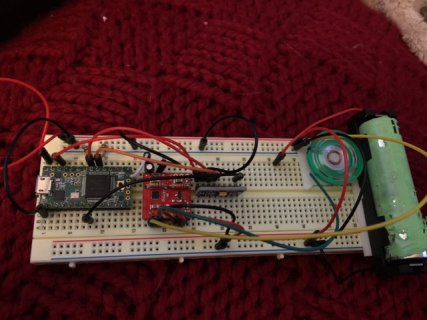

OK, the project is going very well. I have my IMU6050 working in conjunction with the teensy. I set up several synthesized sounds following http://www.dblondin.com/071807.html, using pulse wave forms with filtering and it does a pretty decent hum. I then used the gyro rate magnitude to vary continuously the frequency and amplitude of one of the sounds. Although I'm not happy with the the synthesized swing sound I came up with, it's a very cool effect to have it smoothly varying, rather than triggered once hitting a threshold. On searching, I found this nice video of a wii remote with some sophisticated synthesized sound techniques - would be wonderful to reproduce that. I guess they use a technique called granular synthesis. I found some free packages that support this kind of stuff (csound). Seems like the kind of think I could work on for the next few years to couple something like that in. ;) In the meantime, I tried converting some of the professionally created saber sounds and playing them, and a single file fills up the memory (no SD card yet). So I am definitely going to add an SD card. I figure I can get those sounds working while I continue to play with synthesized sounds.
QUESTIONS:
1) If I am getting an SD card anyway, I was considering trying to cram the Teensy audio card into the saber somehow, since it comes with one, and that would also get me 16 bit sound. However, it is about 1/4" too big. Would it be possible for me to cut off the side with the headphones since I won't be using them? Comparing the schematic and board picture here: https://www.pjrc.com/store/teensy3_audio.html, it looks like I might be OK, as that section has the flash memory spot (not used now), the headphones, and the volume control. It looks like maybe I could trim a little bit off the other side too.
2) Whether or not I use the sound card (I think I will get one in any case to play with) I got an amp off sparkfun - https://www.sparkfun.com/products/11044. It's a bit big and I'm not completely happy with the quality at the volume I am looking for. I have an 8 ohm speaker and looking for around 1W. Any other ideas for a very compact mono amp? I'm not hugely worried about power consumption (this one uses PWM to reduce power use). The LED's I'm driving will draw 1-3 amps anyway. And there will be a kill key to shut off power when not in use. Being able to drive the amp volume using a signal from the teensy would be great too.
3) Is there anyway to compile and run the audio library directly on the PC to make testing of different synth sounds quicker then repeatedly downloading onto the teensy? Probably not, but thought I would ask. Or maybe a generic app that will let you build up synth sounds in a similar way (I'm looking at csound for that).
Again, I am thoroughly impressed with this board and the library! My board so far is pictured below. That amp is almost as big as the teensy! Another note, I am open to building up some circuits myself, like for the amp, and will need to build the mosfet or transistor switches for the high power LEDs. I have been playing with fritzing and may etch a circuit board for these kinds of things.
