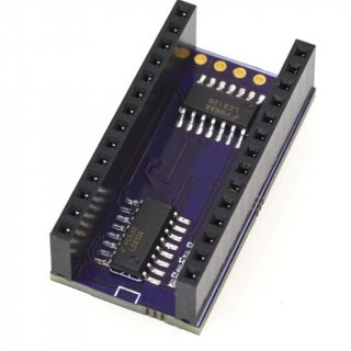

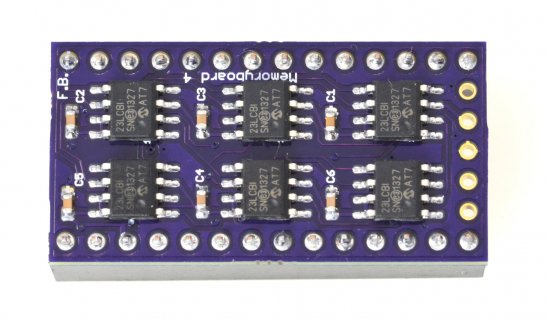

Sorry, have no diagrm. Aren't the IC# numbers printed on the board ?
On the backside (the 8-pin soic the RAMS, ascending numbers, pin 1 is marked),
on the top there is only one soic-16 and one soic-14 so nothing can not be confused.
All 'C' are 0.1uf, all R something like 10K or more..
Pls sorry, it's midnight, i can write details tomorrow. I hope it works!
Perhaps solder it without RAMs, and check wether all chipselect-pins are working before adding the RAMs!

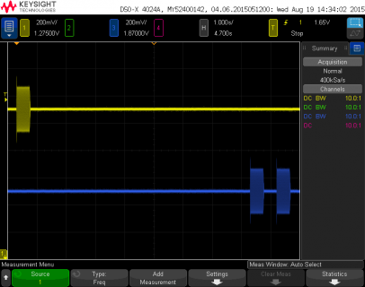

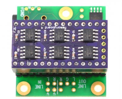

Memoryboard4 is working with all 6 chips!
I've added support in the audio library. Anyone who builds on should be able to have it "just work" with the audio lib. Well, you do have to add the "AUDIO_MEMORY_MEMORYBOARD" parameter to the AudioEffectDelayExternal constructor. See the code below for an example.
In other news, 9 seconds is far beyond my "it's working" attention span for electronics....
Here's a little test program.
(click for full size)
Notice the horizontal scale is 1 second per division!

Are those memory chips: 23LC1024 ? Even with HiDef images my ChipID search_foo is lacking
<edit>: Also is there a drop in FLASH chip that would work interchangeably on this board as designed for static memory?
Frank --- would you mind posting the .sch file, too? i suppose it looks straightforward enough but just to make sure. (ie for people not wanting to stack too many boards or use other pins)
Yes, the RAMs are 23LC1024 SO-8
I think you can use all so-8 "jedec" compatible spi-memory chips for 3Volt - (= all which are ok for the audioboard)
And you could mix them, for example 5 x RAM + 1 x FLASH
Edit: Check the package-width of the chips.

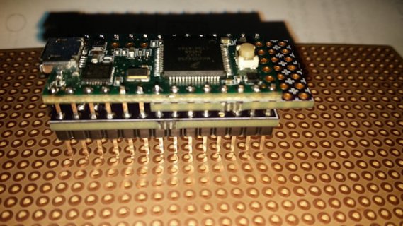

[spam] ;-) Teensy + Connectorboard + Memoryboard = almost same size, only some mm higher, and two rows longer
