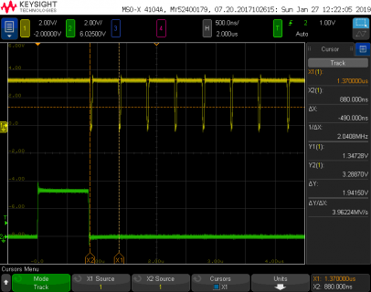

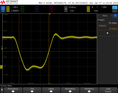

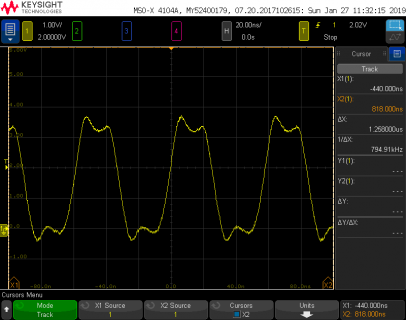

So what does one get? In a nutshell, it is a very asymmetrical signal consisting of a low-going pulse of about 31ns at a frequency of 1.3637 MHz. Surprisingly slow repetition rate, but due to the time consumption of the loop.
With persistence mode turned on to capture any possible timing jitter, there is none to be found.
As noted in other threads, the loop timing has a lot to do with the overall timing, so here is a series of ten pulses repeating via in-line code, then the loop executing.

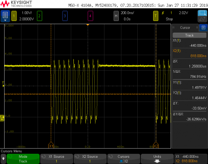

One sees the same pulse width, symmetrical duty cycle within the bursts. The frequency of the burst squarewave is 17.24 MHz and the loop frequency is 1.26 MHz. So this clearly illustrates the trade-off of loops versus in-line coding for fast pulse generation.
The pulses are nicely symmetrical.

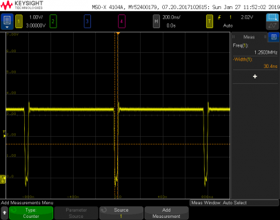

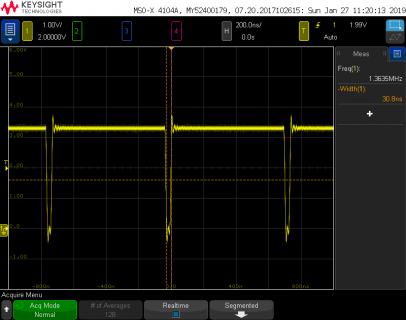

Just as before with just the bit-banged pulse output, but a tiny bit slower due to the port read, we see a low-going pulse approximately 31 ns in width at a frequency of about 16 MHz (15.87 MHz) and an overall repetition rate of 1.25 MHz with no discernable jitter.

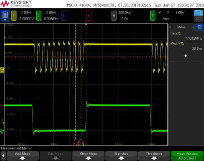

As before, add a separate pin to make a trigger so the oscilloscope can see if the bursts of "acquisition" are jittering.

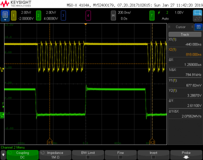

See a nice, jitter-free acquisition at about 16 MHz and a loop repetition rate of 1.13 MHz.

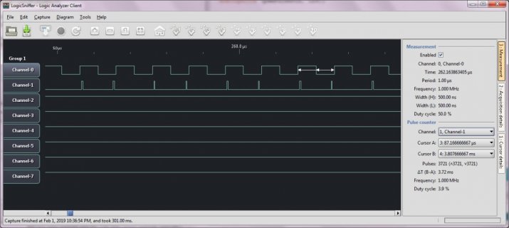

pinMode(startPulsePin, OUTPUT);
CORE_PIN39_CONFIG = PORT_PCR_MUX(1); // no slew rate limit
pinMode(trigPulsePin, OUTPUT);
CORE_PIN16_CONFIG = PORT_PCR_MUX(1); // no slew rate limit
noInterrupts();
FASTRUN void loop() {
digitalWriteFast(trigPulsePin, LOW);
digitalWriteFast(startPulsePin,LOW);
digitalWriteFast(startPulsePin,HIGH);
vReal[0] = GPIOC_PDIR; //Read the ADC
vReal[1] = GPIOC_PDIR; //Read the ADC
vReal[2] = GPIOC_PDIR; //Read the ADC
vReal[3] = GPIOC_PDIR; //Read the ADC
vReal[4] = GPIOC_PDIR; //Read the ADC
digitalWriteFast(trigPulsePin,HIGH);
So 50 Ms/s could be feasible.

//Teensy 3.6 port reads speed test, overclocked 240 MHz
//Brute force bit reads for 10-bit ADC, but scalable with same pins upward to 16 bits.
//G. Kovacs, 1/27/19
int ADCclockPin = 16;
int trigPulsePin = 17;
//int vReal[1024]; //This needs to be double for the FFT routine in use.
int d0,d1,d2,d3,d4,d5,d6,d7,d8,d9; //Created variables to avoid using an array. Not sure if it will scale to 512 though...
pinMode(ADCclockPin,OUTPUT); //Our test start pulse for a hypothetical ADC
pinMode(trigPulsePin,OUTPUT); //Pin for triggering scope at start of each burst
digitalWriteFast(ADCclockPin,HIGH);
for (int i = 0; i<16; i++) //use pins 24..39 in this test
pinMode(i+24,INPUT_PULLUP); //inputs for ADC using pinmode, LSB = 0
noInterrupts();
digitalWriteFast(ADCclockPin,LOW);
d0 = (digitalReadFast(24)<<9)+(digitalReadFast(25)<<8)+(digitalReadFast(26)<<7)+(digitalReadFast(27)<<6)+(digitalReadFast(28)<<5)+(digitalReadFast(29)<<4);
d0 = d0+(digitalReadFast(30)<<3)+(digitalReadFast(31)<<2)+(digitalReadFast(32)<<1)+digitalReadFast(33);
d1 = (digitalReadFast(24)<<9)+(digitalReadFast(25)<<8)+(digitalReadFast(26)<<7)+(digitalReadFast(27)<<6)+(digitalReadFast(28)<<5)+(digitalReadFast(29)<<4);
d1 = d1+(digitalReadFast(30)<<3)+(digitalReadFast(31)<<2)+(digitalReadFast(32)<<1)+digitalReadFast(33);
d2 = (digitalReadFast(24)<<9)+(digitalReadFast(25)<<8)+(digitalReadFast(26)<<7)+(digitalReadFast(27)<<6)+(digitalReadFast(28)<<5)+(digitalReadFast(29)<<4);
d2 = d2+(digitalReadFast(30)<<3)+(digitalReadFast(31)<<2)+(digitalReadFast(32)<<1)+digitalReadFast(33);
d3 = (digitalReadFast(24)<<9)+(digitalReadFast(25)<<8)+(digitalReadFast(26)<<7)+(digitalReadFast(27)<<6)+(digitalReadFast(28)<<5)+(digitalReadFast(29)<<4);
d3 = d3+(digitalReadFast(30)<<3)+(digitalReadFast(31)<<2)+(digitalReadFast(32)<<1)+digitalReadFast(33);
d4 = (digitalReadFast(24)<<9)+(digitalReadFast(25)<<8)+(digitalReadFast(26)<<7)+(digitalReadFast(27)<<6)+(digitalReadFast(28)<<5)+(digitalReadFast(29)<<4);
d4 = d4+(digitalReadFast(30)<<3)+(digitalReadFast(31)<<2)+(digitalReadFast(32)<<1)+digitalReadFast(33);
d5 = (digitalReadFast(24)<<9)+(digitalReadFast(25)<<8)+(digitalReadFast(26)<<7);
d5 = d5+(digitalReadFast(27)<<6)+(digitalReadFast(28)<<5)+(digitalReadFast(29)<<4)+(digitalReadFast(30)<<3)+(digitalReadFast(31)<<2)+(digitalReadFast(32)<<1)+digitalReadFast(33);
d6 = (digitalReadFast(24)<<9)+(digitalReadFast(25)<<8)+(digitalReadFast(26)<<7);
d6 = d6+(digitalReadFast(27)<<6)+(digitalReadFast(28)<<5)+(digitalReadFast(29)<<4)+(digitalReadFast(30)<<3)+(digitalReadFast(31)<<2)+(digitalReadFast(32)<<1)+digitalReadFast(33);
d7 = (digitalReadFast(24)<<9)+(digitalReadFast(25)<<8)+(digitalReadFast(26)<<7);
d7 = d7+(digitalReadFast(27)<<6)+(digitalReadFast(28)<<5)+(digitalReadFast(29)<<4)+(digitalReadFast(30)<<3)+(digitalReadFast(31)<<2)+(digitalReadFast(32)<<1)+digitalReadFast(33);
d8 = (digitalReadFast(24)<<9)+(digitalReadFast(25)<<8)+(digitalReadFast(26)<<7);
d8 = d8+(digitalReadFast(27)<<6)+(digitalReadFast(28)<<5)+(digitalReadFast(29)<<4)+(digitalReadFast(30)<<3)+(digitalReadFast(31)<<2)+(digitalReadFast(32)<<1)+digitalReadFast(33);
d9 = (digitalReadFast(24)<<9)+(digitalReadFast(25)<<8)+(digitalReadFast(26)<<7);
d9 = d9+(digitalReadFast(27)<<6)+(digitalReadFast(28)<<5)+(digitalReadFast(29)<<4)+(digitalReadFast(30)<<3)+(digitalReadFast(31)<<2)+(digitalReadFast(32)<<1)+digitalReadFast(33);
Splitting the reads and shifts was an attempt to balance the HIGH/LOW duty cycle. Writing to array variables, as below, resulted in all of the aforementioned timing glitches. The code *above* was an effort to test this with individual variables, not an array. No go. Need perfectly symmetrical, no-jitter reads each time for an aggressively-designed flash ADC. The example below will show on a scope that the size (> or < one byte) of the array index changes the timing. Bummer, and probably some guru programmer can fix it... :)

I've been experimenting with using a PWM pin for the clock and polling on it. It works consistently at 10 MHz using the code below. If all the pins are on a single GPIO port, I can read it and store the data in almost same amount of time as setting the trigger pulse in the example.
Just to whet your appetite, with some optimization tricks I almost have it working at 30 MHz. I also have an assembly language version that goes to 40 MHz. But I'll keep it simple for now.
const int trigPulsePin = 35;
const int pwmClockPin = 37;
const int pwmFrequency = 10000000;
  analogWriteFrequency (pwmClockPin, pwmFrequency);
  analogWrite (pwmClockPin, 128);
  noInterrupts();
  while (1) {
    // wait for rising edge (loop while low)
    while (!digitalReadFast(pwmClockPin));
    // wait for falling edge (loop while high)
    while (digitalReadFast(pwmClockPin));
    digitalWriteFast(trigPulsePin,LOW);
In order to get good timing data with my logic analyzer, I slow it down to 24 MHz, but the relative timing should be the same. Here's a picture of what it looks like. There is 1 timing pulse between each set of falling clock edges.
